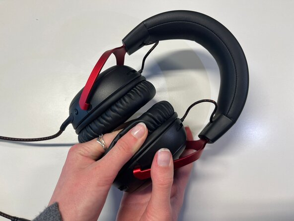

    1. HyperX Cloud III Volume Wheel Replacement, Ear Cushion: step 1, image 1 of 3 HyperX Cloud III Volume Wheel Replacement, Ear Cushion: step 1, image 2 of 3 HyperX Cloud III Volume Wheel Replacement, Ear Cushion: step 1, image 3 of 3
      • Pinch the side of one ear cushion with your thumb.
      • Slide it with your thumb to remove it completely from the outline.
      • Do the same on the other side of the headset if you want to replace both ear cushions.

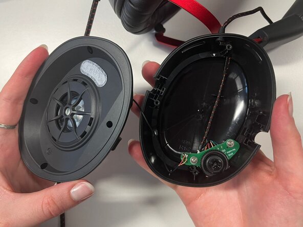

    1. HyperX Cloud III Volume Wheel Replacement, Volume Wheel: step 2, image 1 of 2 HyperX Cloud III Volume Wheel Replacement, Volume Wheel: step 2, image 2 of 2
      • Use a Phillips #2 screwdriver to remove the four 9.4 mm-long screws securing the speaker plate to the earphone.
      • Use your fingers to pull and remove the black speaker plate.

    2. HyperX Cloud III Volume Wheel Replacement: step 3, image 1 of 2 HyperX Cloud III Volume Wheel Replacement: step 3, image 2 of 2
      • Use a Phillips #2 screwdriver to remove the two 6.7 mm-long screws securing the board.

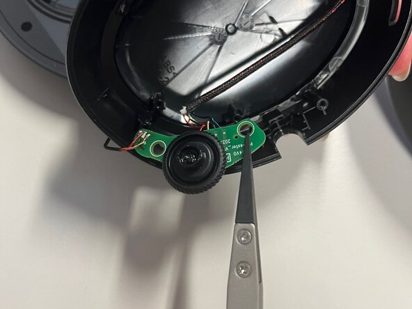

    3. HyperX Cloud III Volume Wheel Replacement: step 4, image 1 of 2 HyperX Cloud III Volume Wheel Replacement: step 4, image 2 of 2
      • Use tweezers to turn the board backward and desolder the wires connected to the sound wheel on this side.

To reassemble your device, follow the steps instructions in reverse order.
Prior knowledge of soldering is required and working with wires is necessary.
