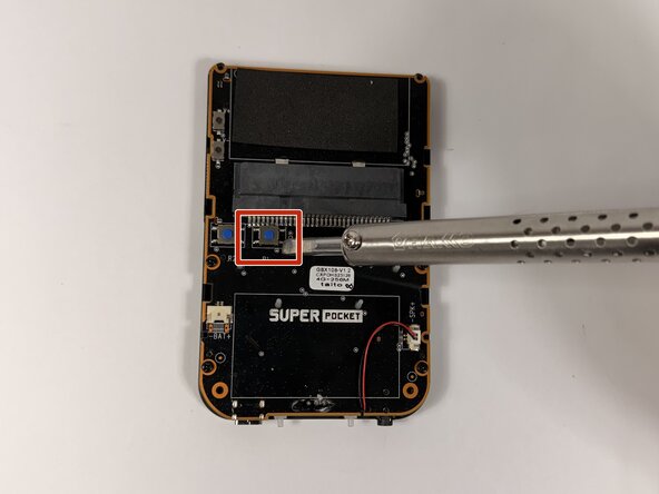

    1. Hyper Mega Tech! Taito Super Pocket Back Buttons Replacement, Back Buttons: step 6, image 1 of 1
      • With the back of the PCB exposed, use a soldering iron to apply heat to all four pads.
      • The soldering iron gets very hot.
      Ask FixBot

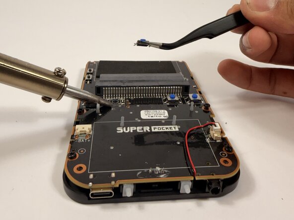

    2. Hyper Mega Tech! Taito Super Pocket Back Buttons Replacement: step 7, image 1 of 3 Hyper Mega Tech! Taito Super Pocket Back Buttons Replacement: step 7, image 2 of 3 Hyper Mega Tech! Taito Super Pocket Back Buttons Replacement: step 7, image 3 of 3
      • Gently grab the button using tweezers and lift the button off the PCB.
      • Repeat this step for every button that needs to be replaced.
