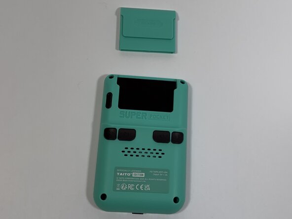

      • Power the device off before starting the disassembly process.
      Ask FixBot
    2. Hyper Mega Tech! Super Pocket Front Button Replacement: step 2, image 1 of 2 Hyper Mega Tech! Super Pocket Front Button Replacement: step 2, image 2 of 2
      • Face the back of the device, then remove the Super Pocket gaming cartridge from the device.

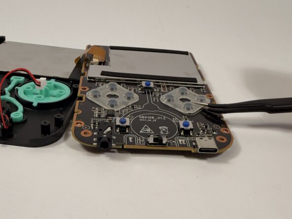

    3. Hyper Mega Tech! Super Pocket Front Button Replacement: step 8, image 1 of 2 Hyper Mega Tech! Super Pocket Front Button Replacement: step 8, image 2 of 2
      • Lift the PCB and rotate it away from the front plastic housing.
      Ask FixBot
    1. Hyper Mega Tech! Super Pocket Front Button Replacement, Front Button: step 9, image 1 of 3 Hyper Mega Tech! Super Pocket Front Button Replacement, Front Button: step 9, image 2 of 3 Hyper Mega Tech! Super Pocket Front Button Replacement, Front Button: step 9, image 3 of 3
      • Using tweezers, lift up the front button and remove it from the PCB.
      Ask FixBot
