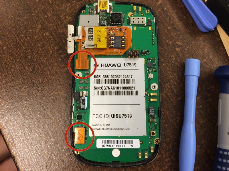

    1. Huawei u7519 Camera Replacement, Camera: step 6, image 1 of 2 Huawei u7519 Camera Replacement, Camera: step 6, image 2 of 2
      • To remove front encasing from the motherboard, first pull back the orange tabs.
      Ask FixBot
    2. Huawei u7519 Camera Replacement: step 7, image 1 of 2 Huawei u7519 Camera Replacement: step 7, image 2 of 2
      • Once the orange tabs are pulled back, carefully pull the motherboard apart from the front casing.
      Ask FixBot
    3. Huawei u7519 Camera Replacement: step 8, image 1 of 1
      • The camera is not removable from the motherboard. Therefore, a new motherboard must be purchased in order to replace the camera.
      Ask FixBot
