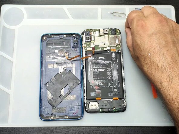

    2. Huawei Y7 2019 Screen Replacement, Remove the Cover: step 2, image 1 of 3 Huawei Y7 2019 Screen Replacement, Remove the Cover: step 2, image 2 of 3 Huawei Y7 2019 Screen Replacement, Remove the Cover: step 2, image 3 of 3
      • Remove the SIM Tray.
      • Use a plastic tool such as a spudger or opening pick to remove the back cover.
      Ask FixBot
    3. Huawei Y7 2019 Screen Replacement: step 3, image 1 of 3 Huawei Y7 2019 Screen Replacement: step 3, image 2 of 3 Huawei Y7 2019 Screen Replacement: step 3, image 3 of 3
      • Remove the seven Phillips screws that are above the battery.
      • Remove the motherboard plastic cover.
      • Disconnect the battery and the fingerprint flex cable using a plastic pry tool.
