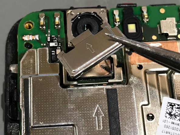

    6. Huawei Nova LCD Replacement, Removing the main board: step 6, image 1 of 3 Huawei Nova LCD Replacement, Removing the main board: step 6, image 2 of 3 Huawei Nova LCD Replacement, Removing the main board: step 6, image 3 of 3
      • Remove the plate covering the from camera. BEWARE! The front cam connector may be attached to the plate, lift it up carefully, removing the connector and then remove the plate to the right.
      • Remove the plate covering the main camera connector and disconnect it.
      • Carefully! Pry from beneath the board gently upwards where indicated, then gently pull to the left/downwards in and upwards direction.

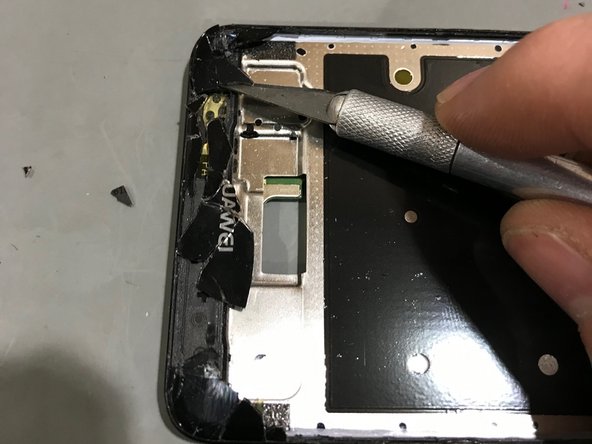

    8. Huawei Nova LCD Replacement, Removing the screen: step 8, image 1 of 3 Huawei Nova LCD Replacement, Removing the screen: step 8, image 2 of 3 Huawei Nova LCD Replacement, Removing the screen: step 8, image 3 of 3
      • Beware! Apply generous amount of heat to the screen, be careful to not burn the plastic LCD frame!
      • Beware! The glass shards are extremely sharp Using a blade or pick get underneath the side of the screen and pry it loose from the frame, use heat where you experience resistance.
      • Lift the screen upwards from the top.

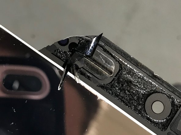

    9. Huawei Nova LCD Replacement, Removing the screen and preparing the frame: step 9, image 1 of 3 Huawei Nova LCD Replacement, Removing the screen and preparing the frame: step 9, image 2 of 3 Huawei Nova LCD Replacement, Removing the screen and preparing the frame: step 9, image 3 of 3
      • Be careful, before removing the screen, underneath the secondary board there is a small flex gently pull it from underneath.
      • Clean the residing glass shards from the LCD frame. Be careful not to cut yourself as these pieces are very sharp.
      • Make sure the frame is cleaned of all glass and most of the adhesive.

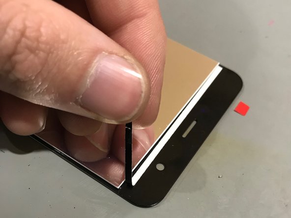

    10. Huawei Nova LCD Replacement, Preparing the new LCD: step 10, image 1 of 3 Huawei Nova LCD Replacement, Preparing the new LCD: step 10, image 2 of 3 Huawei Nova LCD Replacement, Preparing the new LCD: step 10, image 3 of 3
      • Prepare the LCD and apply adhesive.
      • Make sure to transfer the ear-speaker mesh to the new LCD if a new one is not included.
