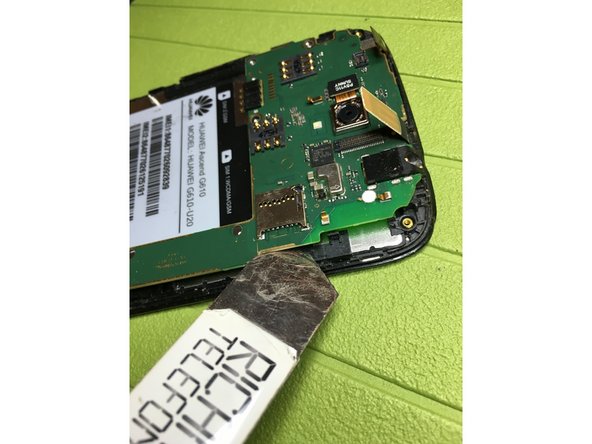

  9. Huawei Ascend G610 Replacement proximity brightness sensor: step 9, image 1 of 3 Huawei Ascend G610 Replacement proximity brightness sensor: step 9, image 2 of 3 Huawei Ascend G610 Replacement proximity brightness sensor: step 9, image 3 of 3
    • With the help of a thin tool, uncouple the mother board interlocked on the plastic hooks
  10. Huawei Ascend G610 Replacement proximity brightness sensor: step 10, image 1 of 1
    • Remove motherboard
  11. Huawei Ascend G610 Replacement proximity brightness sensor: step 11, image 1 of 1
    • With the help of a heat source of the tweezers remove proximity and brightness sensor by replacing it with a new one
