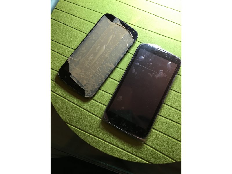

Complete replacement of the assembled frame and touch screen display.

Hi. Do you follow this procedure to replace a shattered screen? Where can I get the specialised little plastic tools designed to do this? Interesting. Thank.J.
jessemark05 - Reply Share
hello, generally the tools are found together with the new display that you buy.  otherwise you can buy them online or at ifixit shop
Smilzo - Reply Share
Got the tools needed,thanks for reply. Do I have to follow this complete procedure just to replace the screen? Jesse.
yes, this is the procedure to replace the complete frame display
