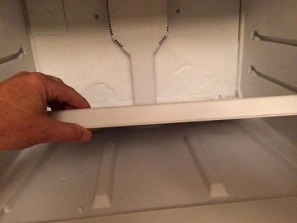

    • This is a run of the mill 12 year old Whirlpool Fridge. That started to develop cooling issues
    • Thermometer showed the fridge to be outside of parameter for food safety.
    Ask FixBot
  2. How to replace the defrost thermostat: step 2, image 1 of 3 How to replace the defrost thermostat: step 2, image 2 of 3 How to replace the defrost thermostat: step 2, image 3 of 3

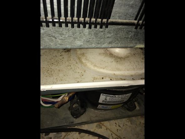

    • First thing to check is the drip pan in the back of the fridge to see if it defrosted. There should be water, or at least some signs of it. This pan was bone dry, which leads to the conclusion that the fridge is not defrosting. Insert wisdom here.

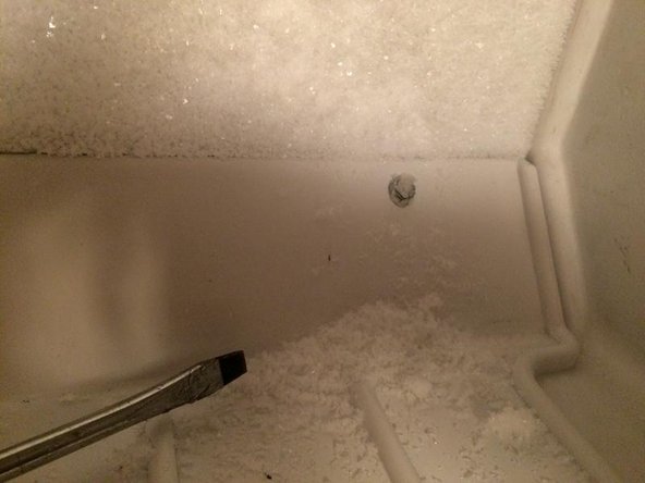

    • Removing the cover from the evaporator is the next step. This is accomplished by removing the floor from the fridge. Empty the freezer part and remove any shelves
    • The floor is held in place by two snap-in fasteners in the front and two screws in the back. Remove the snap in fasteners first. Using a flat tip screwdriver to pop out the left fastener

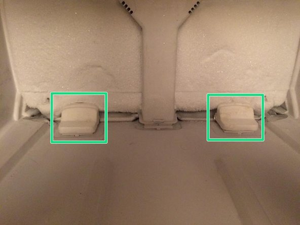

    • After that remove the right one the same way.
    • Next is to remove the two screws on the back of the floor. Using a 1/4" socket and nutdriver remove the left and right screw
    Ask FixBot
  4. How to replace the defrost thermostat: step 4, image 1 of 3 How to replace the defrost thermostat: step 4, image 2 of 3 How to replace the defrost thermostat: step 4, image 3 of 3
    • With the fasteners and screws out, remove the floor.
    • Remove the two styrofoam two air diffuser. Remove those by pulling them straight up.
