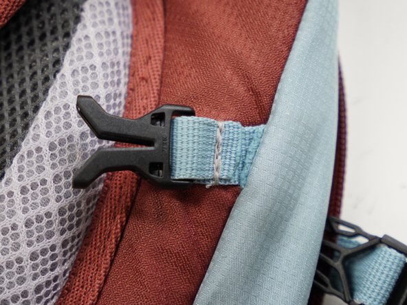

    • Thread the new buckle onto the webbing.
    • Align the webbing edges flush as shown in the video. The end of the webbing can also be folded over once, but this will make the layer significantly thicker and harder to sew.
    • Sew the two layers of webbing together, keeping the presser foot as close to the edge of the buckle as possible.
    • Sew back and forth at least 2-3 times.
    • Cut the thread ends.
    • Done.
  1. How to repair a broken buckle on the side compression strap: step 7, image 1 of 1
    • Result.
