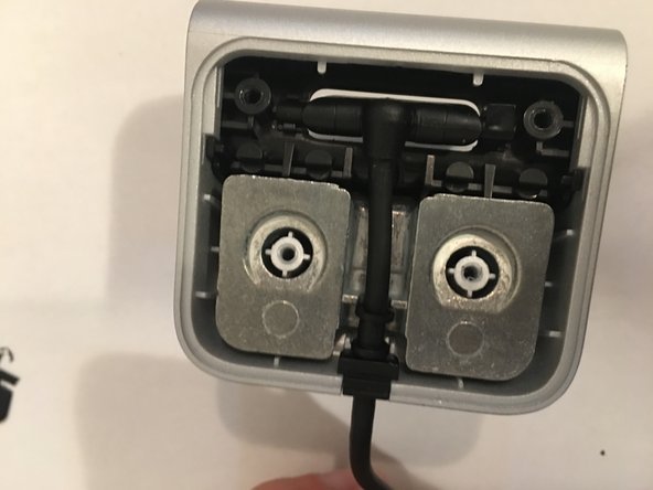

  3. How to modify Belkin Sync Dock for iPhone with protective case: step 3, image 1 of 2 How to modify Belkin Sync Dock for iPhone with protective case: step 3, image 2 of 2
    • Remove the four screws
    • Take down the black plate

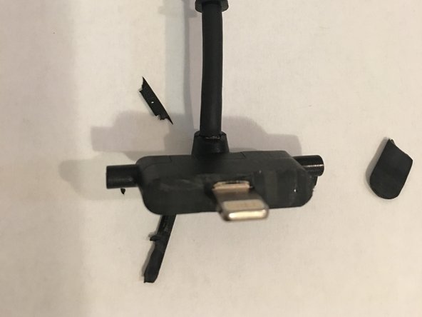

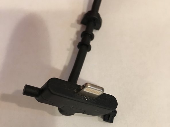

  4. How to modify Belkin Sync Dock for iPhone with protective case: step 4, image 1 of 3 How to modify Belkin Sync Dock for iPhone with protective case: step 4, image 2 of 3 How to modify Belkin Sync Dock for iPhone with protective case: step 4, image 3 of 3
    • Remove the cable from the case (it pops out with ease)
    • Using a cutter, carefully, cut out the plastic around the base of the connector (about half of mm or so)
    • Make sure you don't cut into the lightning connector!
  5. How to modify Belkin Sync Dock for iPhone with protective case: step 5, image 1 of 1
    • Connect the cable to an usb port and check if your phone charges.
    • If it's not enough, take out more of the excess plastic
    • Enjoy!

I got the adjustable one but the plastic got broken by itself and now it works only when it wants. Not sure if I can fix it and replace it with a standard cable.
sorinsbarnea - Reply
