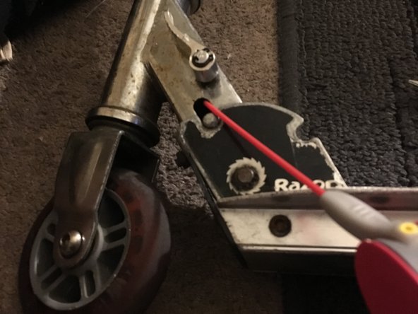

  2. How to fix the Folding Mechanism of a Razor Scooter, Find location: step 2, image 1 of 1
    • Locate where you'll need to add the oil onto the folding mechanism.
  3. How to fix the Folding Mechanism of a Razor Scooter, Add oil: step 3, image 1 of 1
    • You will add oil to this location.
  4. How to fix the Folding Mechanism of a Razor Scooter, Continue step 3: step 4, image 1 of 1
    • You will also add oil to this location.
  5. How to fix the Folding Mechanism of a Razor Scooter, Pull lever: step 5, image 1 of 1
    • After applying the oil and waiting roughly 5 to 10 minutes you’ll pull forward the little lever to fold the scooter
  6. How to fix the Folding Mechanism of a Razor Scooter, Continue step 5: step 6, image 1 of 1
    • Another view of step 5
  7. How to fix the Folding Mechanism of a Razor Scooter, Final product: step 7, image 1 of 1
    • After pulling the lever the scooter will now fold.
