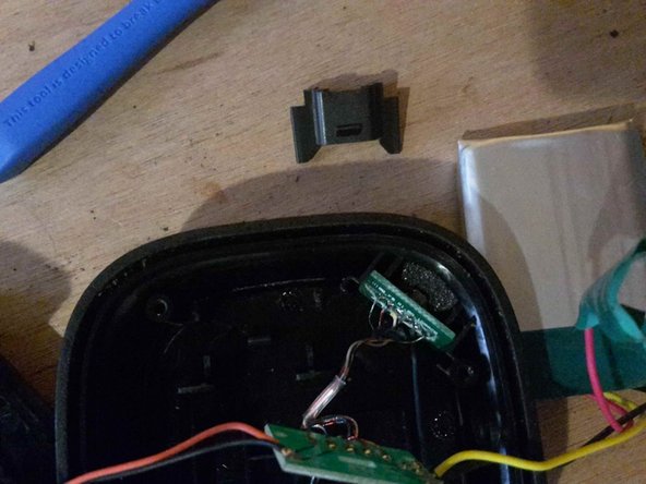

  4. How to fix a broken cable on Marshall Major II Bluetooth, Unscrew earcup covers: step 4, image 1 of 1
    • Unscrew covers with a Philips #0 head
    • 4 screws by earcups
  5. How to fix a broken cable on Marshall Major II Bluetooth, Left earcup casing contents: step 5, image 1 of 1
    • Left earcup casing contains:
    • Lithium battery
    • Button and button connection PCB
    • Left speaker

  10. How to fix a broken cable on Marshall Major II Bluetooth, Ease access to the button board: step 10, image 1 of 2 How to fix a broken cable on Marshall Major II Bluetooth, Ease access to the button board: step 10, image 2 of 2
    • If you need to remove the button board from its casing, there is a small clips allowing to free the plastic piece holding it in place

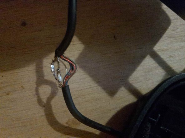

  14. How to fix a broken cable on Marshall Major II Bluetooth, Strip the wire: step 14, image 1 of 2 How to fix a broken cable on Marshall Major II Bluetooth, Strip the wire: step 14, image 2 of 2
    • Strip the wire around the damaged part of the cable
  15. How to fix a broken cable on Marshall Major II Bluetooth, Scratch insulating paint: step 15, image 1 of 1
    • Separate the damaged strand from the others
    • Gently scratch the insulating paint from the strand with a scalpel until you see some shiny, fresh copper color
  16. How to fix a broken cable on Marshall Major II Bluetooth, Repair the damaged strand: step 16, image 1 of 2 How to fix a broken cable on Marshall Major II Bluetooth, Repair the damaged strand: step 16, image 2 of 2
    • Tin the strand
    • If need be, add an additional tinned bit of thin cable to help you reconstruct the strand
    • Test the cable with a multimeter until you manage to reconstruct continuity
  17. How to fix a broken cable on Marshall Major II Bluetooth, Insulate strands: step 17, image 1 of 1
    • Using your favorite option, electrician tape, hot glue or else, make sure the repaired strands never touch each other
    • Reconstruct the cable as solid as you can, using tape or glue
