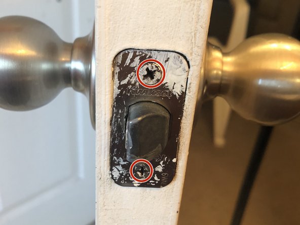

    • Examine the faceplate, checking for any loose screws like you did with your door hinges.
  4. How to fix a Bathroom Door that Will Not Latch: step 4, image 1 of 1
    • Use your screwdriver to tighten any loose screws found on the face plate.

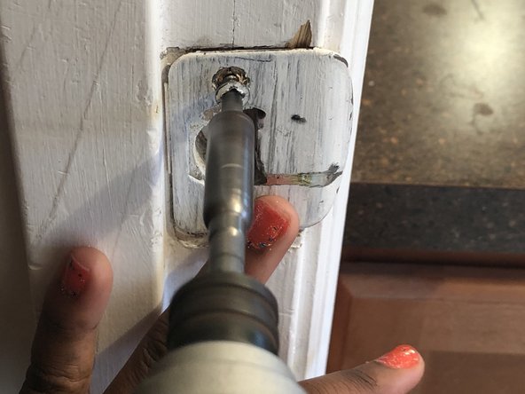

    • Use an electric power drill to remove the screws from your strike plate.

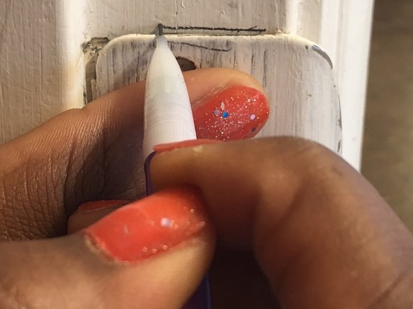

    • Make a line on the wall where you will be moving your strike plate. Use something that you will be able to remove, such as a pencil.

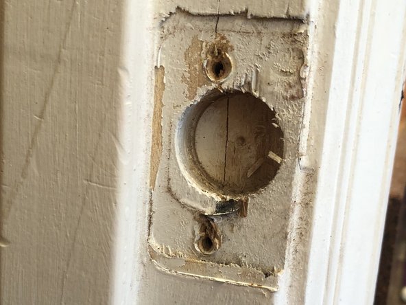

    • Using the wood chisel, chisel out the wood above the line to make space for the new placement of the strike plate.
    • An easy way to do this is to tap the end of the chisel with a hammer.

    • Using an electric drill, screw your strike plate into the wall.
