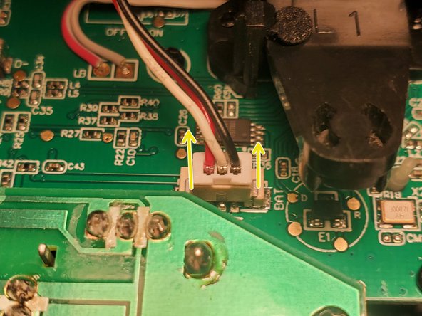

      • You will find 2 connections. (red circle)
      Ask FixBot
    5. How to fix SteelSeries Stratus Duo trigger button (L2/R2), Disconnect the connections: step 5, image 1 of 2 How to fix SteelSeries Stratus Duo trigger button (L2/R2), Disconnect the connections: step 5, image 2 of 2
      • The white strip is the data line. To disconnect, use a tweezer to (1) slide open the black button from both sides , then (2) pull the blue part.
      • The tri-colored wire is the power line. Simply pull it up. (Don't forget it's orientation)
      • Seperate the upper and lower controller case
