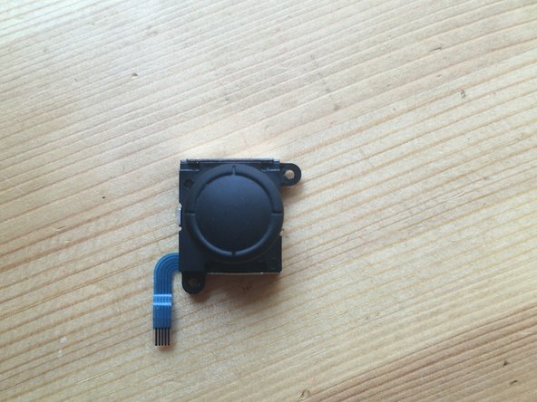

  1. How to fix Nintendo Switch Joy-Con_Drift, Before you start: step 1, image 1 of 1
    • Even if you don't touch the joystick, it will input directions.

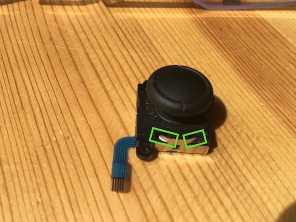

  2. How to fix Nintendo Switch Joy-Con_Drift, Ver1: step 2, image 1 of 1
    • Raise the metal claw next to the joystick. This part will break due to metal fatigue when trying to restore it.

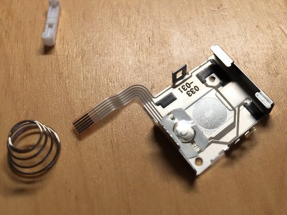

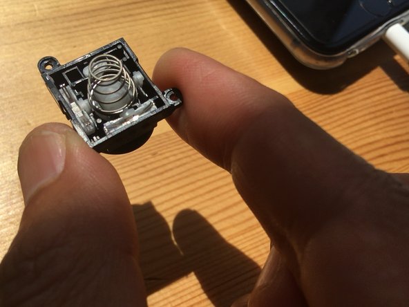

  3. How to fix Nintendo Switch Joy-Con_Drift, Ver1: step 3, image 1 of 1
    • The spring and white plastic parts come off when the back plate is removed.
  4. How to fix Nintendo Switch Joy-Con_Drift, Ver1: step 4, image 1 of 2 How to fix Nintendo Switch Joy-Con_Drift, Ver1: step 4, image 2 of 2
    • Location of metal ring and white plastic parts

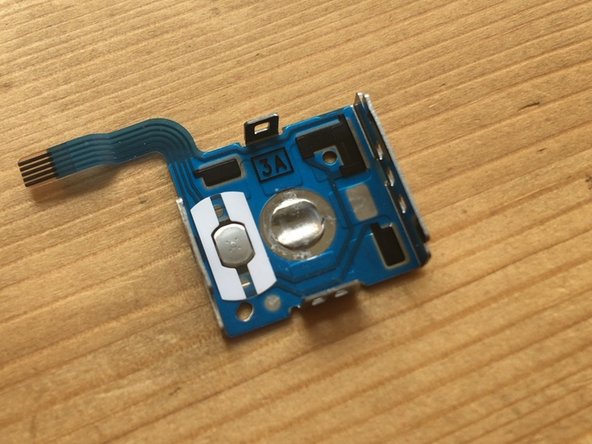

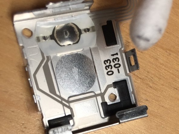

  5. How to fix Nintendo Switch Joy-Con_Drift, Ver1: step 5, image 1 of 3 How to fix Nintendo Switch Joy-Con_Drift, Ver1: step 5, image 2 of 3 How to fix Nintendo Switch Joy-Con_Drift, Ver1: step 5, image 3 of 3
    • Clean the matte black areas with gloss with a cotton swab. *The change in the resistance value (black part) with the silver contact can be read with the position information.

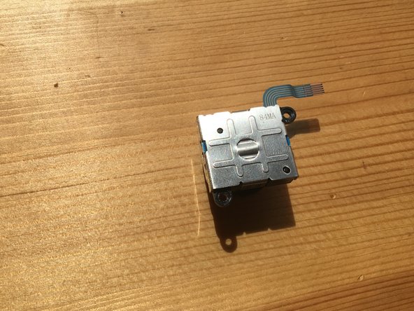

  7. How to fix Nintendo Switch Joy-Con_Drift, Ver2: step 7, image 1 of 2 How to fix Nintendo Switch Joy-Con_Drift, Ver2: step 7, image 2 of 2
    • The metal press shape is different.

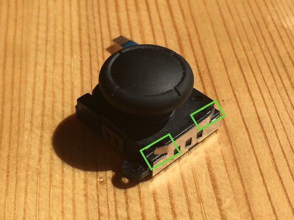

  8. How to fix Nintendo Switch Joy-Con_Drift, Ver2: step 8, image 1 of 3 How to fix Nintendo Switch Joy-Con_Drift, Ver2: step 8, image 2 of 3 How to fix Nintendo Switch Joy-Con_Drift, Ver2: step 8, image 3 of 3
    • Use sharp-nose pliers and straighten the bent hinge part.

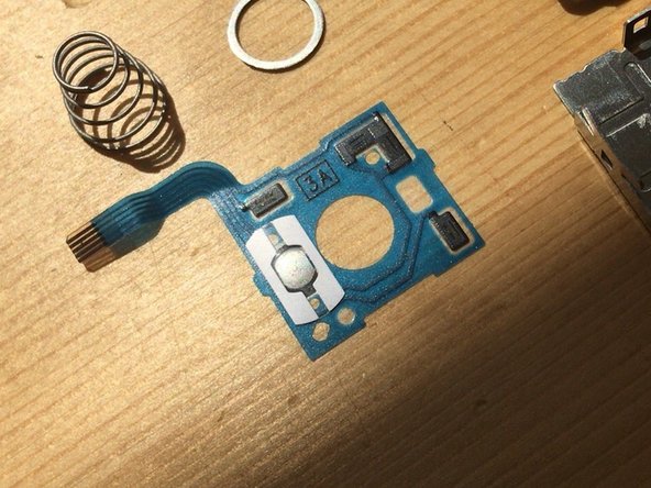

    • Disassembled parts springs, metal washers, parts for push button, film substrate, metal frame
    • The metal frame is greased, so do not clean it here. (Wipe here to generate plastic powder.)

  12. How to fix Nintendo Switch Joy-Con_Drift, Ver2: step 12, image 1 of 3 How to fix Nintendo Switch Joy-Con_Drift, Ver2: step 12, image 2 of 3 How to fix Nintendo Switch Joy-Con_Drift, Ver2: step 12, image 3 of 3
    • The black part is a sensor that reads the resistance value. There is a line-like gloss here, so use a cotton swab to clean it.
    • CAUTION Wipe the metal terminals with a cotton swab dipped in alcohol. Be careful as it bends easily.

  18. How to fix Nintendo Switch Joy-Con_Drift, Photo after work: step 18, image 1 of 1
    • The joystick is back in action!
