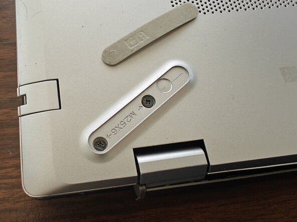

  2. How to access the insides of your HP Pavilion 15-cs: SUPER EASY, Remove screws: step 2, image 1 of 3 How to access the insides of your HP Pavilion 15-cs: SUPER EASY, Remove screws: step 2, image 2 of 3 How to access the insides of your HP Pavilion 15-cs: SUPER EASY, Remove screws: step 2, image 3 of 3
    • There will be about 6 screws you'll need to remove.
    • You will have to at least partially remove the rubber feet to access 3 of the screws.
    • The screws are really tiny, so I recommend putting them in a Tupperware or Ziploc if you don't have a magnetic screw tray.

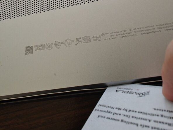

  3. How to access the insides of your HP Pavilion 15-cs: SUPER EASY, Credit Card or Pry Tool Step: step 3, image 1 of 2 How to access the insides of your HP Pavilion 15-cs: SUPER EASY, Credit Card or Pry Tool Step: step 3, image 2 of 2
    • You'll use a credit card, ID card, or pry tool to separate the bottom of the laptop from the rest of it. Make sure it's plastic, not metal.
    • You might want to use multiple to hold sections open as you work your way around.
  4. How to access the insides of your HP Pavilion 15-cs: SUPER EASY, Pop That Sucker Off: step 4, image 1 of 1
    • You remove the bottom to reveal the guts of your machine.
