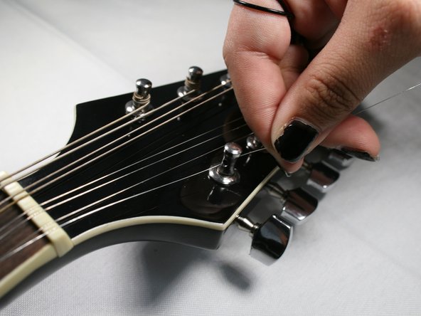

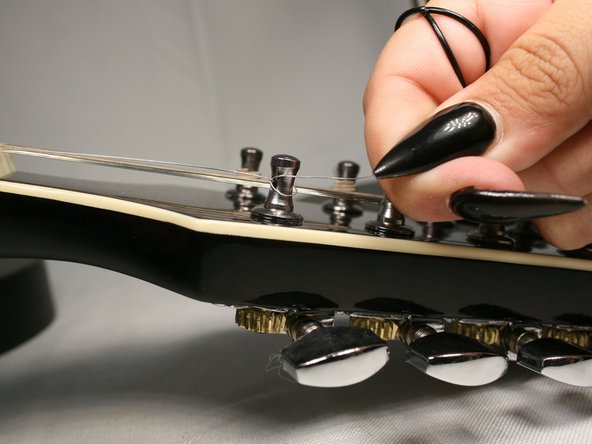

    • Lay the Mandolin face up on a flat surface.
    • Start at the headstock of the Mandolin, and unwind the wire string by turning the tuning peg in a clockwise rotation until it becomes loose and easy to remove.

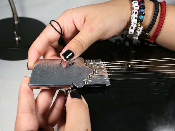

  2. How to Replace the Strings on your Rogue RM-100A A-Style Mandolin: step 2, image 1 of 3 How to Replace the Strings on your Rogue RM-100A A-Style Mandolin: step 2, image 2 of 3 How to Replace the Strings on your Rogue RM-100A A-Style Mandolin: step 2, image 3 of 3
    • At the tailpiece of the Mandolin, use both of your thumbs to apply pressure to push the tailpiece cover away from you.
    • The edge of the tailpiece is a bit sharp. If your fingers hurt, use a small towel or cloth to cushion your thumbs as you push.
  3. How to Replace the Strings on your Rogue RM-100A A-Style Mandolin: step 3, image 1 of 2 How to Replace the Strings on your Rogue RM-100A A-Style Mandolin: step 3, image 2 of 2
    • Remove the string you are replacing from the tailpiece.
    • The string should be easy to remove.

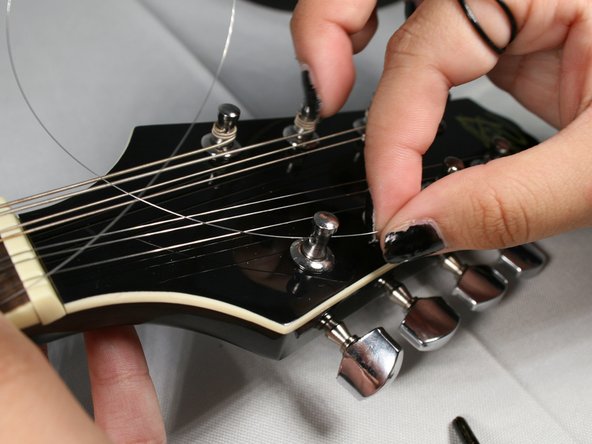

  5. How to Replace the Strings on your Rogue RM-100A A-Style Mandolin: step 5, image 1 of 2 How to Replace the Strings on your Rogue RM-100A A-Style Mandolin: step 5, image 2 of 2

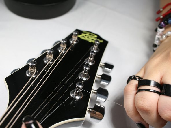

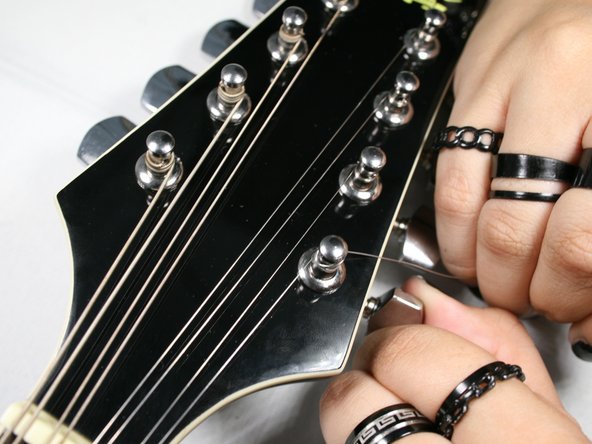

    • Insert the string into the hole of the tuning post all the way through.
  6. How to Replace the Strings on your Rogue RM-100A A-Style Mandolin: step 6, image 1 of 3 How to Replace the Strings on your Rogue RM-100A A-Style Mandolin: step 6, image 2 of 3 How to Replace the Strings on your Rogue RM-100A A-Style Mandolin: step 6, image 3 of 3

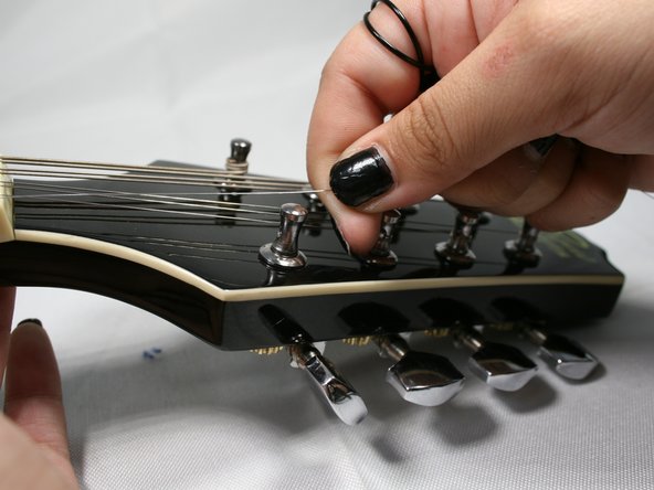

    • Loosen the hold of the string.
    • Turn the excess string to the left and pull it under the string.
    • Again, pull the excess string up and over to the left.
    • This creates a sort of hold/knot on the string.
  7. How to Replace the Strings on your Rogue RM-100A A-Style Mandolin: step 7, image 1 of 3 How to Replace the Strings on your Rogue RM-100A A-Style Mandolin: step 7, image 2 of 3 How to Replace the Strings on your Rogue RM-100A A-Style Mandolin: step 7, image 3 of 3

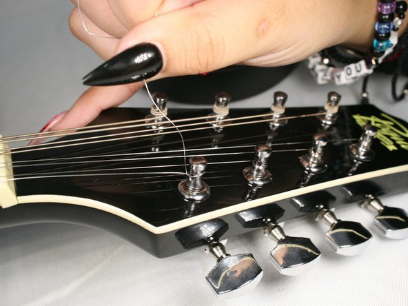

    • Pull the knot.
    • Twist the tuning pegs in a counterclockwise rotation.
    • Twist towards the tailpiece.

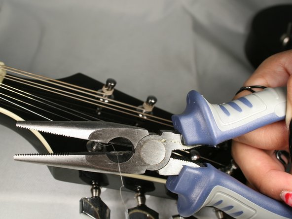

    • Cut any excess string with pliers.
