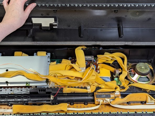

  2. How to Replace the Keys on a Yamaha PSR-330 Piano Keyboard: step 2, image 1 of 2 How to Replace the Keys on a Yamaha PSR-330 Piano Keyboard: step 2, image 2 of 2
    • Carefully remove the back casing with both hands from the bottom.
    • The back casing is connected via a ribbon cable so make sure to hold it steady before proceeding.

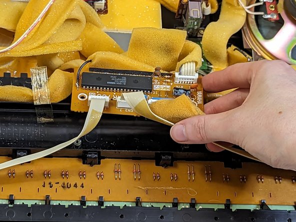

  3. How to Replace the Keys on a Yamaha PSR-330 Piano Keyboard: step 3, image 1 of 1
    • While holding the back casing, unplug the ribbon cable connecting both front and back casings together.
    • Set aside the back casing.

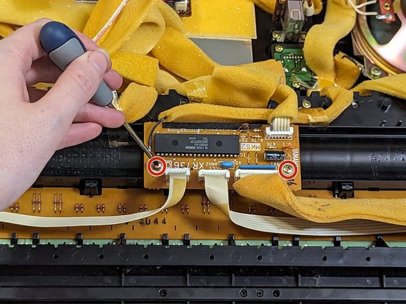

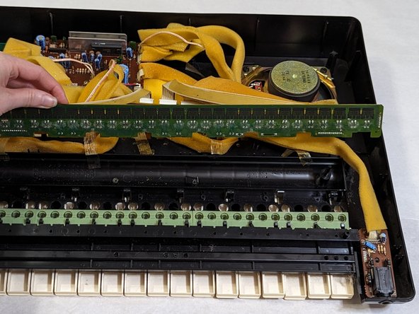

  4. How to Replace the Keys on a Yamaha PSR-330 Piano Keyboard: step 4, image 1 of 2 How to Replace the Keys on a Yamaha PSR-330 Piano Keyboard: step 4, image 2 of 2
    • Remove both 7 mm Phillips #1 screws from the XR736(C) PCB.
    • Carefully move the XR736(C) PCB away from the contact pad.

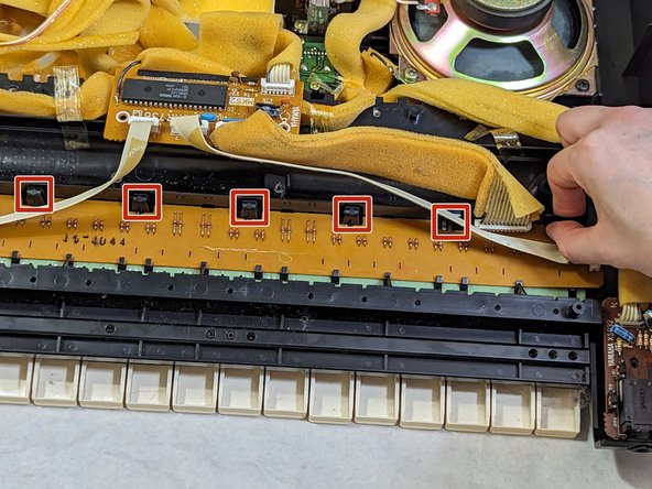

  5. How to Replace the Keys on a Yamaha PSR-330 Piano Keyboard: step 5, image 1 of 3 How to Replace the Keys on a Yamaha PSR-330 Piano Keyboard: step 5, image 2 of 3 How to Replace the Keys on a Yamaha PSR-330 Piano Keyboard: step 5, image 3 of 3
    • Push down on the black tabs on the contact pad.
    • Starting from the ends, carefully remove the contact pad by wiggling it out.
    • Be careful of the smaller black hooks on the bottom. These are fragile.

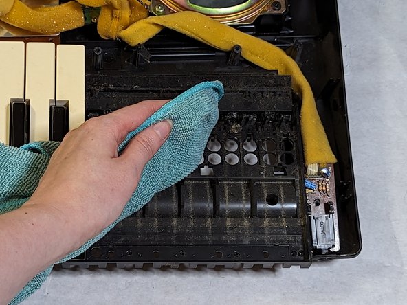

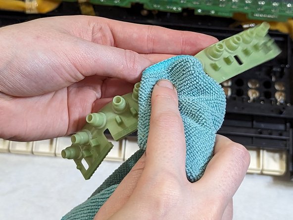

  6. How to Replace the Keys on a Yamaha PSR-330 Piano Keyboard: step 6, image 1 of 3 How to Replace the Keys on a Yamaha PSR-330 Piano Keyboard: step 6, image 2 of 3 How to Replace the Keys on a Yamaha PSR-330 Piano Keyboard: step 6, image 3 of 3
    • Flip over the contact pad.
    • Using a clean cloth, dust the contact pad and the silicone molds.

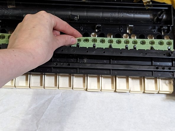

  7. How to Replace the Keys on a Yamaha PSR-330 Piano Keyboard: step 7, image 1 of 3 How to Replace the Keys on a Yamaha PSR-330 Piano Keyboard: step 7, image 2 of 3 How to Replace the Keys on a Yamaha PSR-330 Piano Keyboard: step 7, image 3 of 3
    • Remove the silicone molds and dust the other side of them.
    • Set them aside.

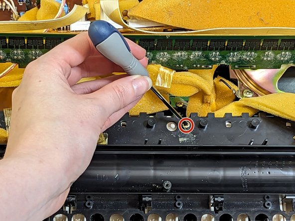

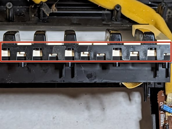

  8. How to Replace the Keys on a Yamaha PSR-330 Piano Keyboard: step 8, image 1 of 3 How to Replace the Keys on a Yamaha PSR-330 Piano Keyboard: step 8, image 2 of 3 How to Replace the Keys on a Yamaha PSR-330 Piano Keyboard: step 8, image 3 of 3
    • Remove the 10 mm Phillips #1 screw(s) from the case.
    • The screws would be in the middle and above the keys.
    • Flip the keys rights-side up.

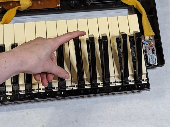

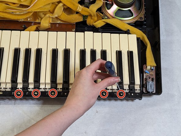

  9. How to Replace the Keys on a Yamaha PSR-330 Piano Keyboard: step 9, image 1 of 3 How to Replace the Keys on a Yamaha PSR-330 Piano Keyboard: step 9, image 2 of 3 How to Replace the Keys on a Yamaha PSR-330 Piano Keyboard: step 9, image 3 of 3
    • Remove the 7 mm Phillips #1 screws from the keys together
    • Remove the keys in sections using both hands.
    • Clean the area using a clean cloth and/or compressed air.

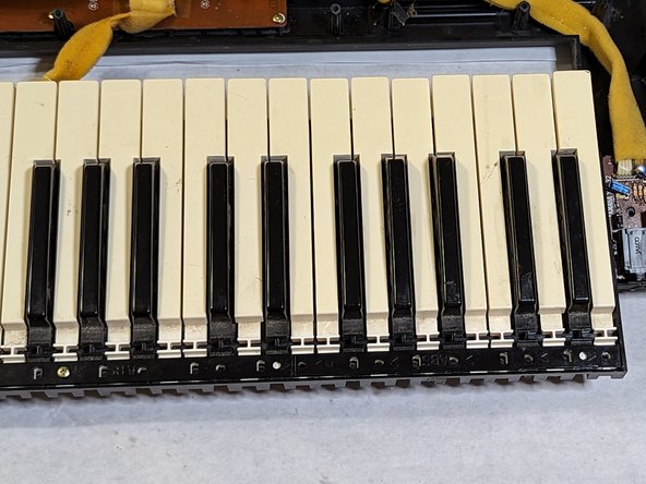

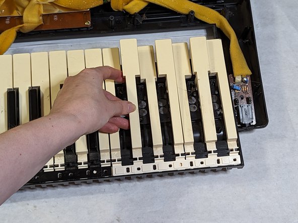

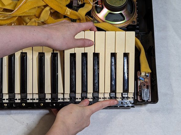

  10. How to Replace the Keys on a Yamaha PSR-330 Piano Keyboard: step 10, image 1 of 3 How to Replace the Keys on a Yamaha PSR-330 Piano Keyboard: step 10, image 2 of 3 How to Replace the Keys on a Yamaha PSR-330 Piano Keyboard: step 10, image 3 of 3
    • Using the tabs on the keys, insert them into their respective slots.

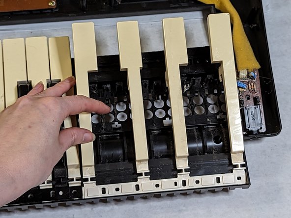

  11. How to Replace the Keys on a Yamaha PSR-330 Piano Keyboard: step 11, image 1 of 3 How to Replace the Keys on a Yamaha PSR-330 Piano Keyboard: step 11, image 2 of 3 How to Replace the Keys on a Yamaha PSR-330 Piano Keyboard: step 11, image 3 of 3
    • Place the set of keys back one at a time.
    • The two sets of white keys go on the bottom, and the set of black keys go on top.
