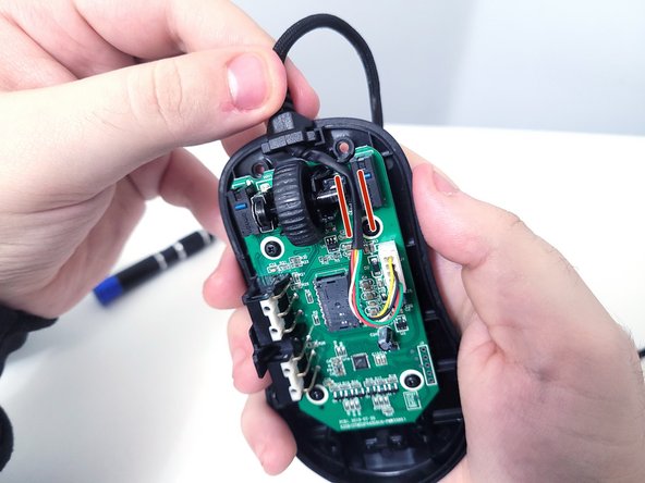

  7. How to Replace the Cable on the Endgame Gear XM1 Mouse: step 7, image 1 of 3 How to Replace the Cable on the Endgame Gear XM1 Mouse: step 7, image 2 of 3 How to Replace the Cable on the Endgame Gear XM1 Mouse: step 7, image 3 of 3
    • Route the cable between the scroll wheel and the Omron sensor.
    • Place the stress relief in the designated opening at the base of the bottom shell.
    • Be sure to push the cable down so that it is firmly secured between the mouse wheel and the right mouse switch.
