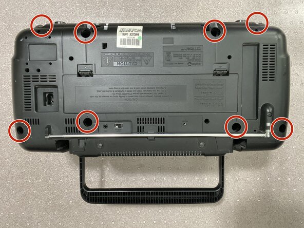

    • Use a Phillips #1 screwdriver to remove eight 3.4 mm screws from the back of the unit.
    • The screw head type may vary between different devices.
    • Some older devices have deep screw holes, which may require a specialized screw driver to access.
