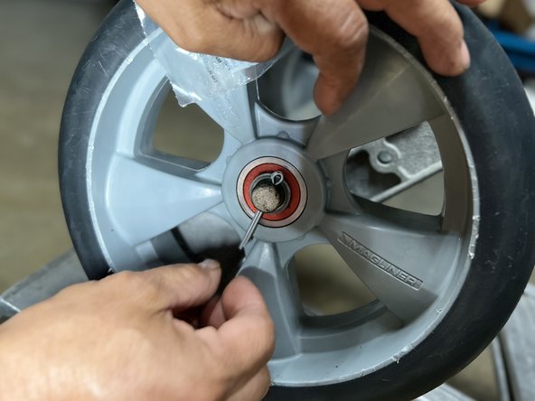

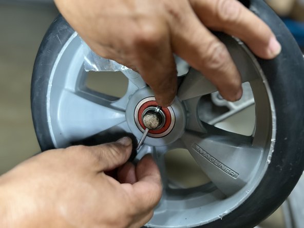

    • Straighten the bottom of the cotter pin with the pliers to slide out the cotter pin.

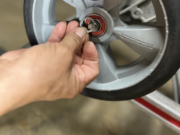

    • Remove the stainless steel washer(s) before pulling out the wheel(s) from the spindle.
