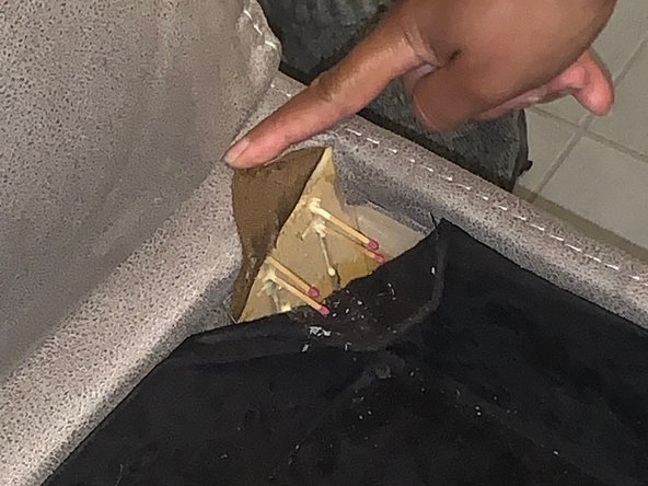

    • Partially remove the inside fabric to access screw holes.
    • If the fabric is stapled down, you can use the Phillips screwdriver to loosen the staples. In this case, the fabric was already coming off so it was easy to pull back by hand.
  2. How to Repair the Hinges on a Sofa Storage Compartment: step 2, image 1 of 2 How to Repair the Hinges on a Sofa Storage Compartment: step 2, image 2 of 2
    • Apply glue to the match stick and insert it into the screw holes.
    • Depending on the size of the hole, you may need more than 1 match stick for each hole. Toothpicks will also work in place of a match stick.

    • Break off the end of the match sticks and use a hammer to secure it in the holes
    • A gentle tap with the hammer is all you need to set the stick into the hole.
