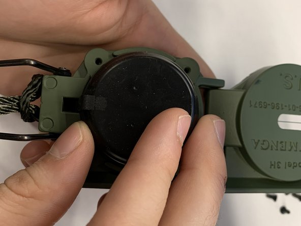

After extensive use, a Model 3H Cammenga Lensatic Compass tends to give less accurate headings because burrs develop on the needle preventing the dial from rotating. This guide will help you fix this issue in order to maximize accuracy of the compass. Step 7 requires you to use a pocket knife and any sharp tool should be handled with caution.

    1. How to Repair a Lensatic Compass, How to Repair a Lensatic Compass: step 1, image 1 of 3 How to Repair a Lensatic Compass, How to Repair a Lensatic Compass: step 1, image 2 of 3 How to Repair a Lensatic Compass, How to Repair a Lensatic Compass: step 1, image 3 of 3

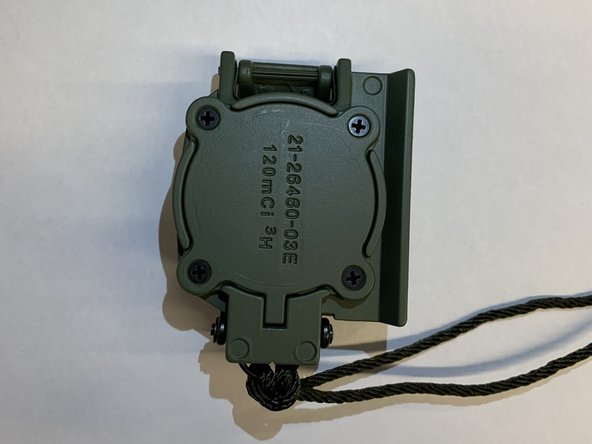

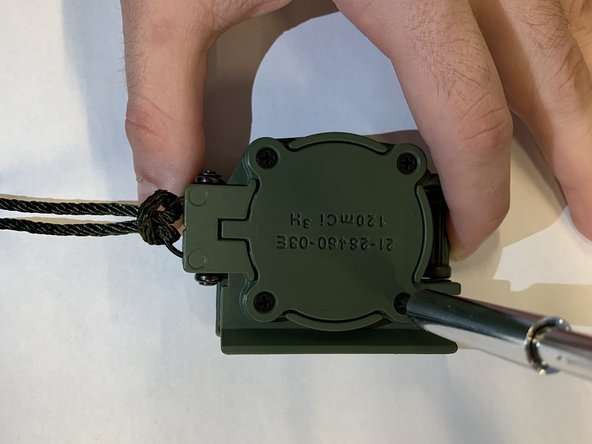

      • Using a Phillips #1 screwdriver, remove the four screws in the bottom of the compass.

    2. How to Repair a Lensatic Compass: step 2, image 1 of 3 How to Repair a Lensatic Compass: step 2, image 2 of 3 How to Repair a Lensatic Compass: step 2, image 3 of 3
      • Use the pocket knife or any flat edge to pop the bottom plate out of the compass.

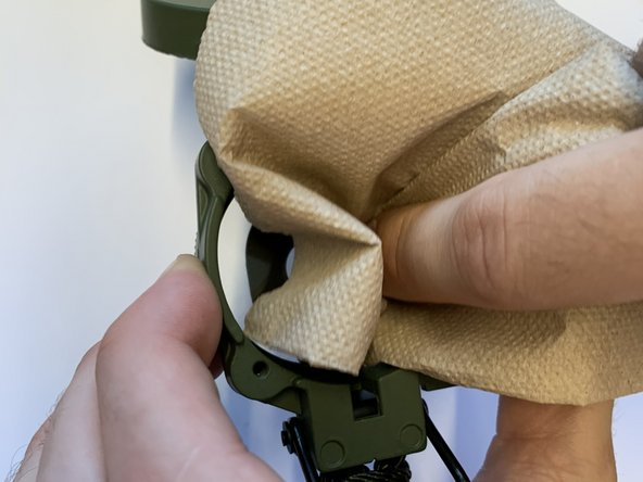

      • Clean the inside of the outer compass with a microfiber towel.

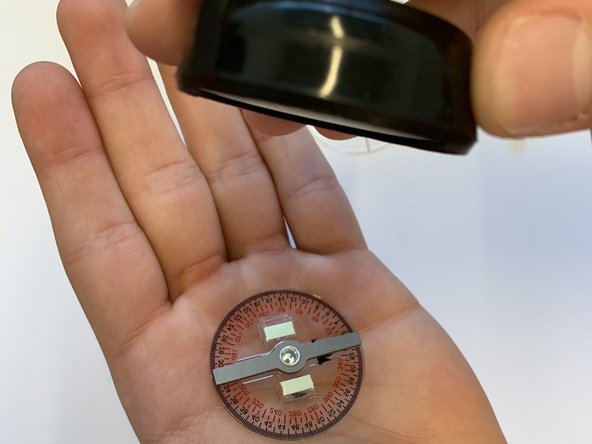

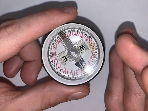

    6. How to Repair a Lensatic Compass: step 6, image 1 of 2 How to Repair a Lensatic Compass: step 6, image 2 of 2
      • Take out the floating dial. Just flip the inner compass over.
      • Use a pencil and put some graphite on the inside of the center of the floating dial.
      Ask FixBot

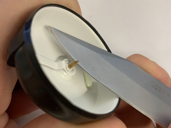

    7. How to Repair a Lensatic Compass: step 7, image 1 of 2 How to Repair a Lensatic Compass: step 7, image 2 of 2
      • Use the edge of the pocket knife to sharpen the needle upwards.
      • Go around the needle and be sure not to push too hard as to create an even worse burr.

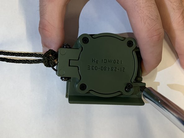

    13. How to Repair a Lensatic Compass: step 13, image 1 of 3 How to Repair a Lensatic Compass: step 13, image 2 of 3 How to Repair a Lensatic Compass: step 13, image 3 of 3
      • Screw all the screws back in and you are finished.
