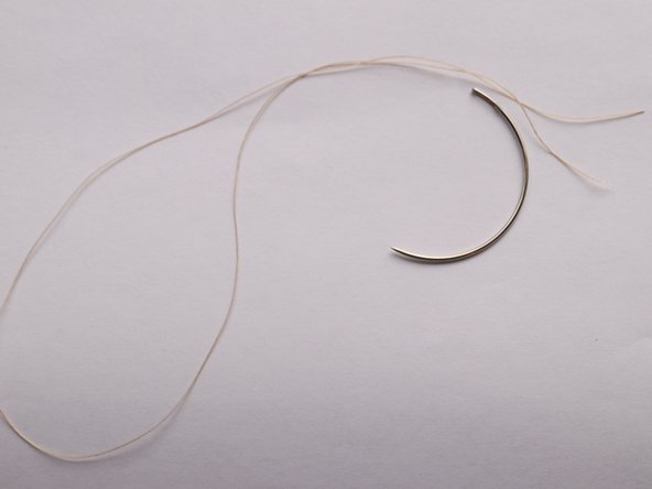

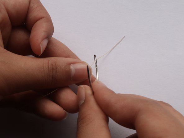

    • Cut the upholstery thread about 3 times the length of the hole.
    • Insert the thread into the eye (hole) of the curved needle.
    • The first time using a sewing needle might result in pricking your finger.
    • Take both ends of the thread and tie a knot together

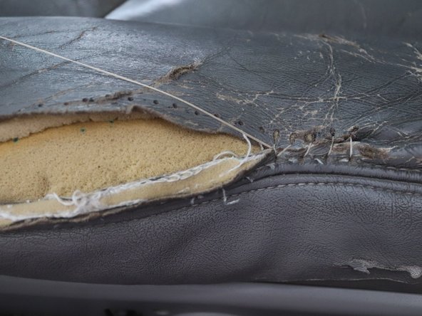

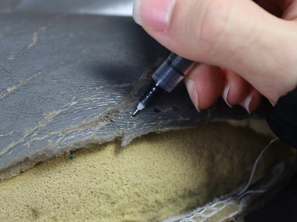

  3. How to Repair a Leather Car Seat Rip With Needle and Thread: step 3, image 1 of 3 How to Repair a Leather Car Seat Rip With Needle and Thread: step 3, image 2 of 3 How to Repair a Leather Car Seat Rip With Needle and Thread: step 3, image 3 of 3

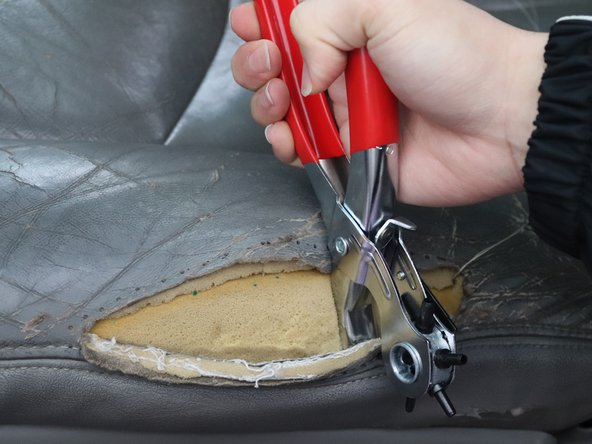

    • Mark a line of dots (1 centimeter apart) along the edge of the tear.
    • Do this on both sides of the tear.

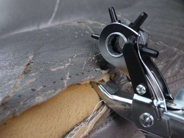

  4. How to Repair a Leather Car Seat Rip With Needle and Thread: step 4, image 1 of 3 How to Repair a Leather Car Seat Rip With Needle and Thread: step 4, image 2 of 3 How to Repair a Leather Car Seat Rip With Needle and Thread: step 4, image 3 of 3
    • Use the leather hole puncher to punch holes on all the black dots you drew.
    • When you finish hole punching, there should be a row of holes along the edge of the rip.

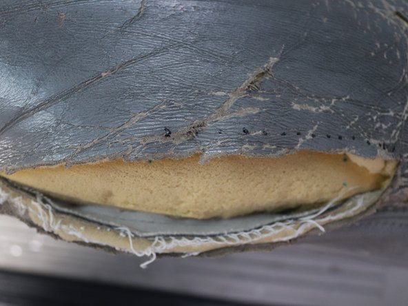

  5. How to Repair a Leather Car Seat Rip With Needle and Thread: step 5, image 1 of 3 How to Repair a Leather Car Seat Rip With Needle and Thread: step 5, image 2 of 3 How to Repair a Leather Car Seat Rip With Needle and Thread: step 5, image 3 of 3

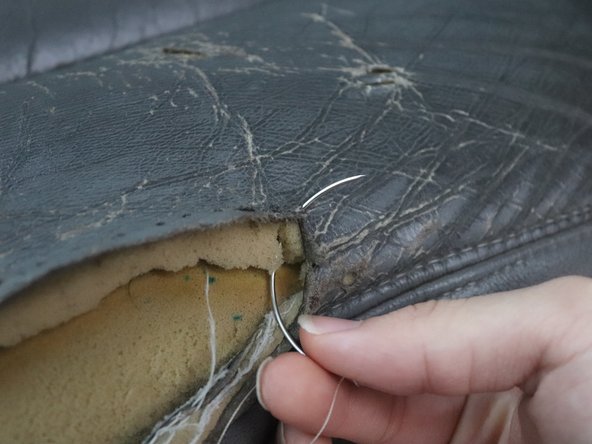

    • Insert the curved needle under the first hole in the top right corner.
    • Pull the needle halfway through the hole; the thread will look like a loop.
    • Insert the needle through the thread loop.
    • Pull the needle all the way, anchoring the thread to the edge of the fabric.

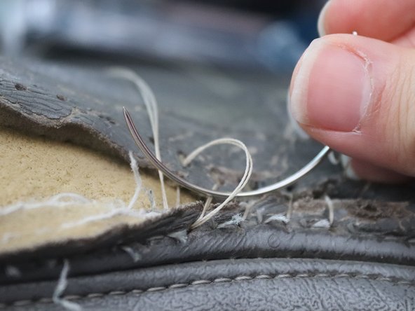

  6. How to Repair a Leather Car Seat Rip With Needle and Thread: step 6, image 1 of 3 How to Repair a Leather Car Seat Rip With Needle and Thread: step 6, image 2 of 3 How to Repair a Leather Car Seat Rip With Needle and Thread: step 6, image 3 of 3

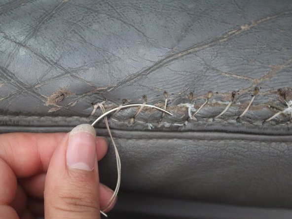

    • Insert the needle on the opposite side of the rip in the first hole on the bottom right.
    • Pull the thread all the way through.
    • Insert the curved needle in the hole to the left of the first hole on the top row.
    • Thread the needle through the second hole on the bottom row and pull tight.
    • Repeat this process three more times.

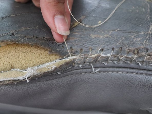

    • The thread should zig-zag across both edges of the leather and begin pulling the rip together.
  7. How to Repair a Leather Car Seat Rip With Needle and Thread: step 7, image 1 of 3 How to Repair a Leather Car Seat Rip With Needle and Thread: step 7, image 2 of 3 How to Repair a Leather Car Seat Rip With Needle and Thread: step 7, image 3 of 3
    • When you reach your fifth stitch, tie a knot to add extra strength before continuing.
    • Loop the needle through the hole you just pulled the thread out of, creating a circle of thread.
    • Insert the needle through this thread loop and pull tight to create a knot.

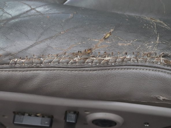

  8. How to Repair a Leather Car Seat Rip With Needle and Thread: step 8, image 1 of 3 How to Repair a Leather Car Seat Rip With Needle and Thread: step 8, image 2 of 3 How to Repair a Leather Car Seat Rip With Needle and Thread: step 8, image 3 of 3
    • Repeat step 6 and 7 all the way to the end of the tear. The two edges of the tear should be sewn together.
    • Loop the thread into the last stitch made.
