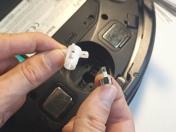

    • Lift the plastic axle plug from the rest of the RoboVac using the needle-nose pliers.
  5. How to Repair a Eufy RoboVac 15C Max that Drives Erratically: step 5, image 1 of 1
    • Examine the small metal pin clinging to the plastic axle plug.
    • If the pin is bent out of shape or broken, the swivel wheel will not rotate properly, affecting the RoboVac's movement.
  6. How to Repair a Eufy RoboVac 15C Max that Drives Erratically: step 6, image 1 of 1
    • Clear away any obstructions such as dirt or hair.
    • Adjust or replace the metal pin as necessary.

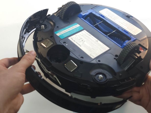

  8. How to Repair a Eufy RoboVac 15C Max that Drives Erratically: step 8, image 1 of 2 How to Repair a Eufy RoboVac 15C Max that Drives Erratically: step 8, image 2 of 2

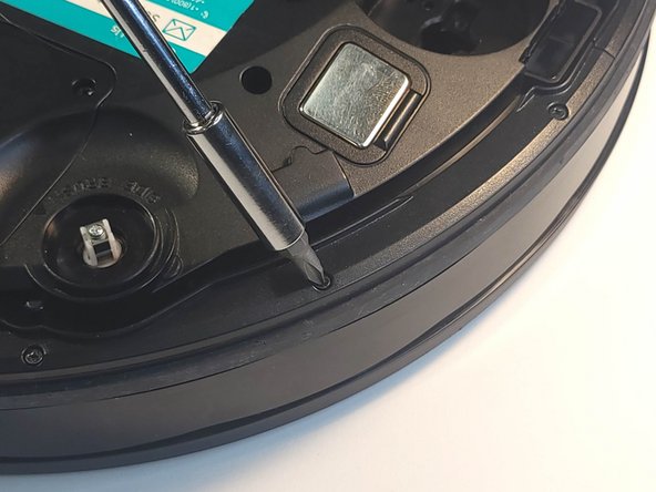

    • Use a Phillips #1 screwdriver to remove the eight 7.6 mm screws along the underside of the RoboVac's bumper.
  9. How to Repair a Eufy RoboVac 15C Max that Drives Erratically: step 9, image 1 of 2 How to Repair a Eufy RoboVac 15C Max that Drives Erratically: step 9, image 2 of 2
    • Remove the two black plastic fasteners that were held in place by the screws.
  10. How to Repair a Eufy RoboVac 15C Max that Drives Erratically: step 10, image 1 of 1
    • Remove the RoboVac's front bumper, which was held in place by the fasteners.
    • Avoid yanking the connecting cable between the RoboVac and the bumper.

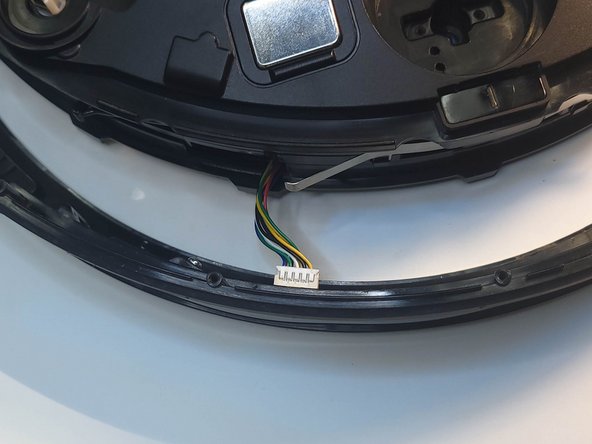

  11. How to Repair a Eufy RoboVac 15C Max that Drives Erratically: step 11, image 1 of 3 How to Repair a Eufy RoboVac 15C Max that Drives Erratically: step 11, image 2 of 3 How to Repair a Eufy RoboVac 15C Max that Drives Erratically: step 11, image 3 of 3
    • Unplug the connecting cable between the RoboVac and the bumper.
    • Do not pull the cords of the connecting cable; this can rip the cords from the white block. Use force on the white block instead.

    • A jammed or broken bumper will cause the RoboVac to falsely believe there are obstructions ahead of it, causing it to drive erratically.
