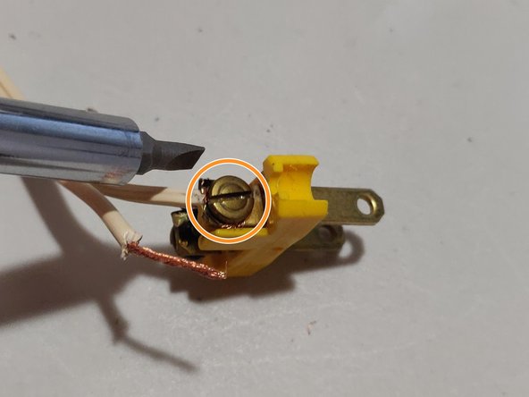

    • Use a flathead screwdriver to remove the two 3 mm screws from the power adapter.

  6. How to Repair a Burnt Wire for a Light Globe: step 6, image 1 of 3 How to Repair a Burnt Wire for a Light Globe: step 6, image 2 of 3 How to Repair a Burnt Wire for a Light Globe: step 6, image 3 of 3
    • Grab the terminal of the power adapter and loosen the 3 mm screws of the terminal if needed.
    • Wrap one exposed copper wire around one loosened 3 mm screw and tighten the screw immediately.
    • Repeat the second bullet point for the second copper wire.

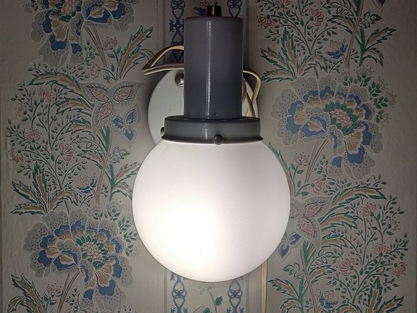

  8. How to Repair a Burnt Wire for a Light Globe: step 8, image 1 of 2 How to Repair a Burnt Wire for a Light Globe: step 8, image 2 of 2
    • Plug in the power adapter into a functioning power outlet.
    • The light globe should now successfully turn on!
