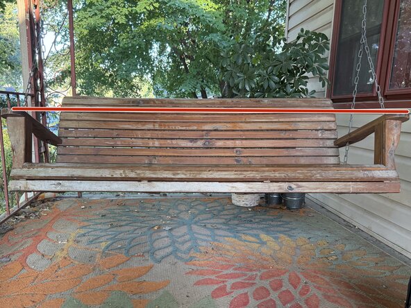

    • (Before) Backward-Tilted Swing

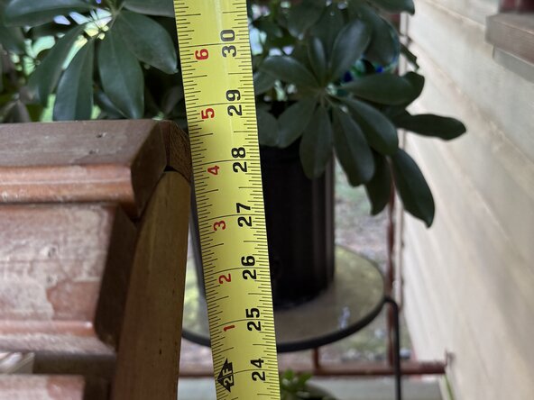

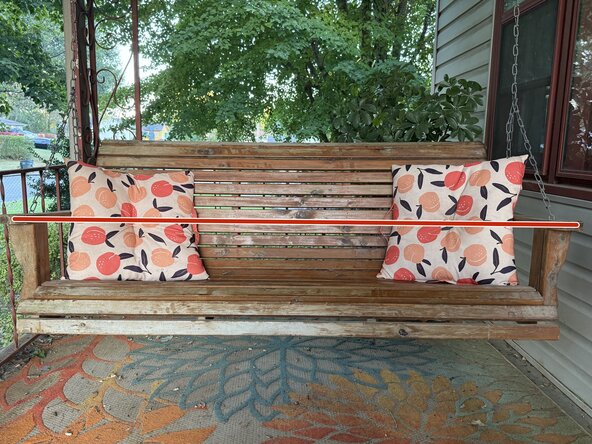

    • Use a measuring tape to check and record the height of the swing from the ground to the armrest. Repeat this step on the other side.
    • Use a measuring tape to check and record the height of the swing from the ground to the top of the swing. Repeat this step on the other side.
    • Record these measurements to compare later.
    • (Optional) Place a level on the seat of the swing to check if it is level. Adjust the chains as needed until the bubble is centered.
    • Notice how the bubble is not centered to show the swing is level.

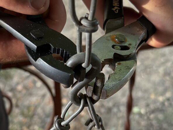

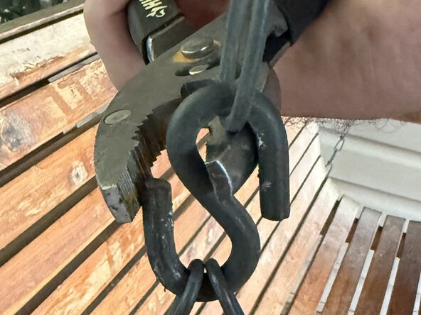

  3. How to Repair a Backward-Tilted Porch Swing: step 3, image 1 of 2 How to Repair a Backward-Tilted Porch Swing: step 3, image 2 of 2
    • Use one pair of pliers to hold the S-hook steady.
    • Use the second pair of pliers to gently open the bottom side of the hook, allowing the chain links to slide off. This provides better leverage and stability.
    • For other hook types, gently open or unscrew the hook and slide the chain off without bending or damaging the hook.
    • Use caution when opening the hook to avoid injury from any sharp edges.
    • Repeat this step to open the hook on the other side of the swing.
    • There should be a noticeable difference in the openings at the top and bottom of the hook.

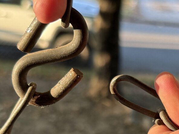

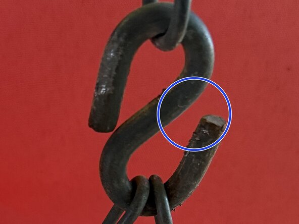

  4. How to Repair a Backward-Tilted Porch Swing: step 4, image 1 of 2 How to Repair a Backward-Tilted Porch Swing: step 4, image 2 of 2
    • Slide the chain closest to the back of the swing off the hook after opening it.
    • Other types of hooks may require different methods, but most of them should allow the chain to gently slide off.
    • Compare previous measurements to new measurements to ensure they are consistent on both sides. This is crucial to a level swing.

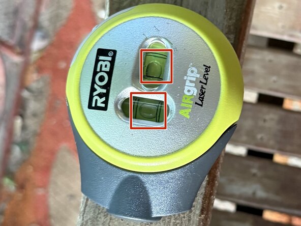

    • (Optional) Place a level on the armrest of the swing to check if it is level.
    • The bubbles are resting between the two lines, indicating that the swing is level.
