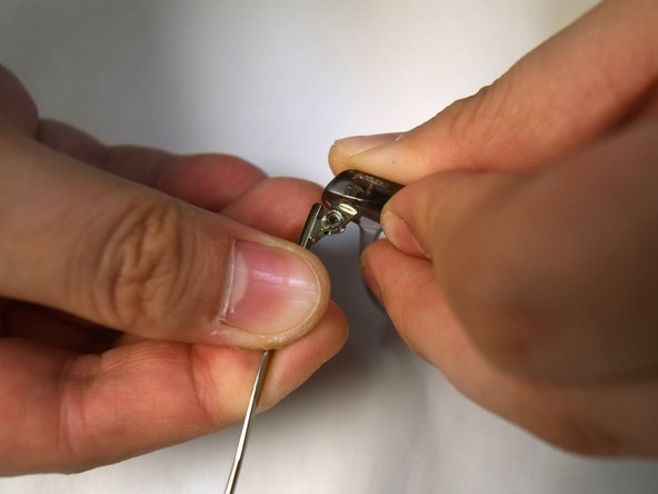

    • Select a screw from the assorted eyeglasses screws box to begin the size-fitting process.
    • Start from the smaller sizes and work your way up until the screw body fits in the eyeglass frame hinge.
  2. How to Repair Warped Eyeglasses Arm Joint and Replace the Screw: step 2, image 1 of 3 How to Repair Warped Eyeglasses Arm Joint and Replace the Screw: step 2, image 2 of 3 How to Repair Warped Eyeglasses Arm Joint and Replace the Screw: step 2, image 3 of 3
    • Place the screw into the end piece of the eyeglasses.
    • If the screw does not fit, repeat Steps 1 and 2 until you find a match.
    • Set the screw aside once you have the perfect fit.

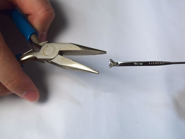

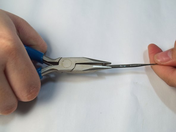

  3. How to Repair Warped Eyeglasses Arm Joint and Replace the Screw: step 3, image 1 of 3 How to Repair Warped Eyeglasses Arm Joint and Replace the Screw: step 3, image 2 of 3 How to Repair Warped Eyeglasses Arm Joint and Replace the Screw: step 3, image 3 of 3
    • Position the pliers so that both sides of the arm joint are on the inside of the pliers.
    • Apply slight pressure to the pliers to bend the warped arm joint back into place.
    • Too much pressure might break the arm joint or make the arm joint too tight for the next step, so be very mindful about the pressure!

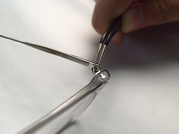

  4. How to Repair Warped Eyeglasses Arm Joint and Replace the Screw: step 4, image 1 of 2 How to Repair Warped Eyeglasses Arm Joint and Replace the Screw: step 4, image 2 of 2
    • Align the arm joint to the end piece of the eyeglasses.
    • If the two pieces do not align or the fit is too loose, repeat Step 3 to adjust the arm joint.

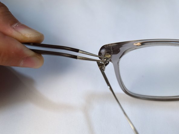

  5. How to Repair Warped Eyeglasses Arm Joint and Replace the Screw: step 5, image 1 of 3 How to Repair Warped Eyeglasses Arm Joint and Replace the Screw: step 5, image 2 of 3 How to Repair Warped Eyeglasses Arm Joint and Replace the Screw: step 5, image 3 of 3
    Tool used on this step:
    Buy
    • Place the screw through the arm joint and end piece using tweezers.

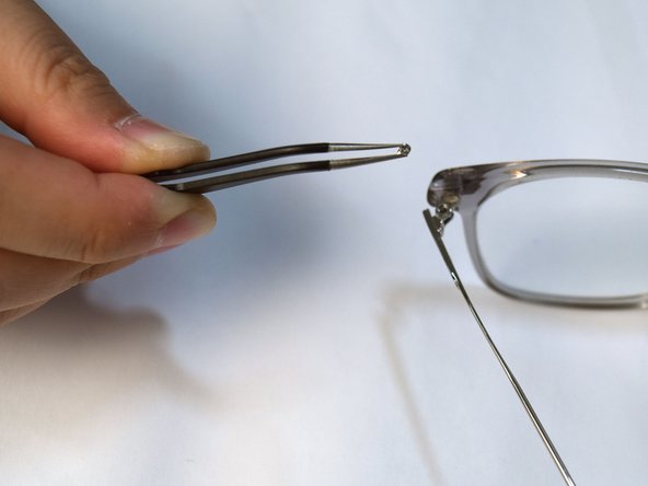

  6. How to Repair Warped Eyeglasses Arm Joint and Replace the Screw: step 6, image 1 of 3 How to Repair Warped Eyeglasses Arm Joint and Replace the Screw: step 6, image 2 of 3 How to Repair Warped Eyeglasses Arm Joint and Replace the Screw: step 6, image 3 of 3
    • Tighten the screw with the screwdriver.
    • Depending on your eyeglasses screws, choose the appropriate screwdriver size and shape.
