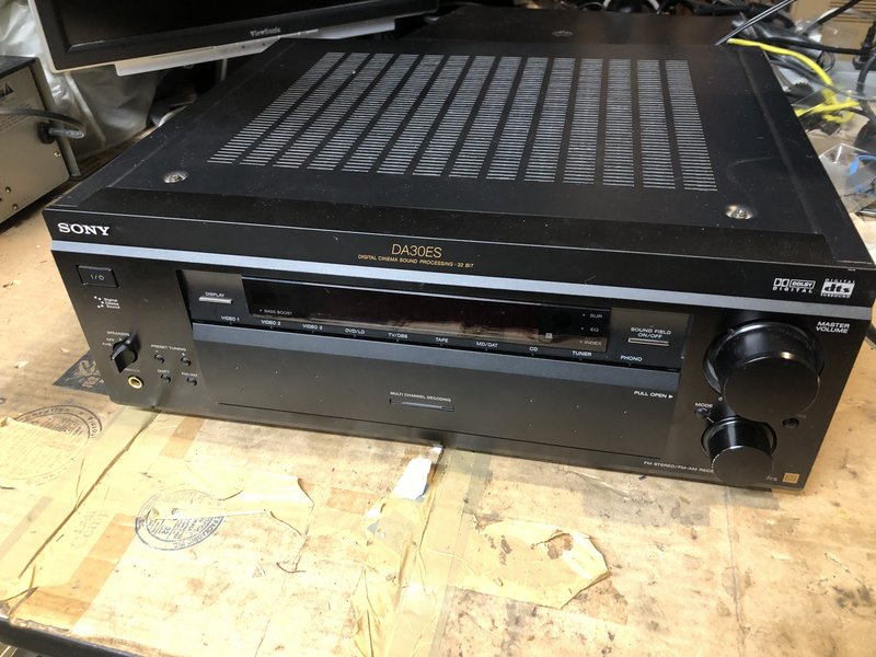

How to Repair Sony Receiver STR-DA30ES
    1. How to Repair Sony Receiver STR-DA30ES, Find the Manual and Schematics: step 1, image 1 of 1
      • To do this kind of repair, you usually need circuit diagrams to guide your work. These are sometimes found in the operating manual, but are more likely to be found in a product service manual.
      • Documents for many products are available online for free, even for fairly old items like this receiver.
      • In this case, I lucked out because the manufacturer web site had the operating manual as well as the service manual.

    3. How to Repair Sony Receiver STR-DA30ES, Orientation: step 3, image 1 of 1
      • This Sony receiver has a large number of circuit boards. The service manual has a diagram showing their identities and locations.
      • Because the unit won't power on, we're going to focus on the PS (Power Supply) board and the AC board.
      • Another thing to identify as a potential problem is the power switch, which has its own small circuit board behind the front panel of the receiver.

      • In my case, the old capacitor discharged twenty times faster than a new one. I concluded that the receiver's problem was a bad capacitor.
