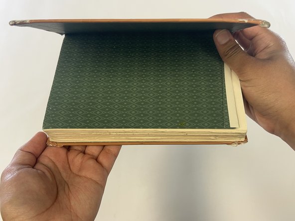

    • Open the book to one cover corner.
    • Apply the PVA glue on a bumped corner using the glue tip or a small paintbrush.
    • Coat the worn layers with the same paintbrush.
    • The corner layers should be well-saturated for them to stick together.

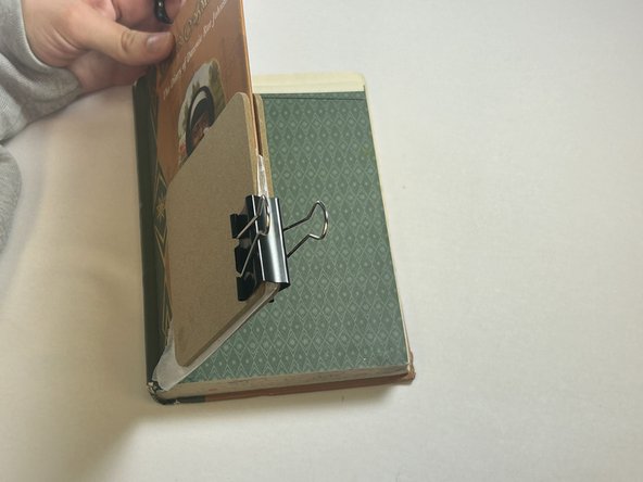

  4. How to Repair Bumped Corners on a Hardcover Book: step 4, image 1 of 1
    • Put one piece of wood chipboard on each side of the corner.
    • The wood chipboard will prevent the book corner from denting in the next step.
  5. How to Repair Bumped Corners on a Hardcover Book: step 5, image 1 of 1
    • Clamp everything together.
    • Let everything dry for 30 minutes.
    • This book-binding method ensures enough time and support for the bumped corner to transform into better condition.
