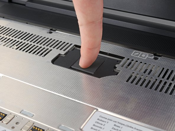

  2. How to Remove the Expansion Bay in your Framework Laptop 16", Remove the touchpad spacers: step 2, image 1 of 3 How to Remove the Expansion Bay in your Framework Laptop 16", Remove the touchpad spacers: step 2, image 2 of 3 How to Remove the Expansion Bay in your Framework Laptop 16", Remove the touchpad spacers: step 2, image 3 of 3
    • Use your fingers to slide the touchpad spacer toward the bottom edge of the laptop and unclip it.
    • If you're having trouble, check if the corresponding Input Module latch is properly unlocked.
    • Lift the touchpad spacer off the laptop and remove it.

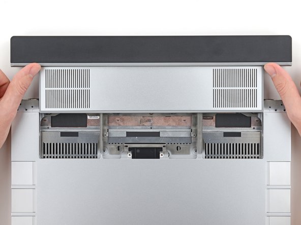

  10. How to Remove the Expansion Bay in your Framework Laptop 16", Loosen the expansion bay screws: step 10, image 1 of 2 How to Remove the Expansion Bay in your Framework Laptop 16", Loosen the expansion bay screws: step 10, image 2 of 2
    • Use a T5 Torx screwdriver to loosen the two captive screws securing the expansion bay.
    • Close the interposer door before continuing.

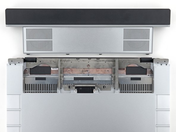

  11. How to Remove the Expansion Bay in your Framework Laptop 16", Remove the expansion bay: step 11, image 1 of 3 How to Remove the Expansion Bay in your Framework Laptop 16", Remove the expansion bay: step 11, image 2 of 3 How to Remove the Expansion Bay in your Framework Laptop 16", Remove the expansion bay: step 11, image 3 of 3
    • Close your laptop and flip it over.
    • Slide the expansion bay out of the laptop and remove it.
    • The bay should slide out easily. If you feel any resistance, check that the screws holding it in place are fully loosened.
