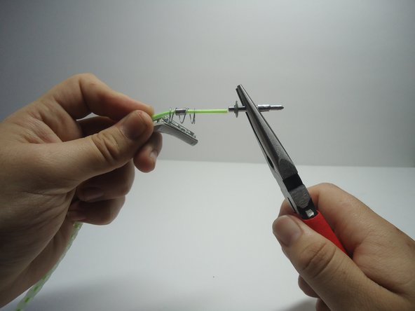

  7. How to Remove a Filament Clog on a Cubify Cube 3D Printer (3rd Generation): step 7, image 1 of 2 How to Remove a Filament Clog on a Cubify Cube 3D Printer (3rd Generation): step 7, image 2 of 2
    • Heat the needle using a lighter, making sure that the flame does not touch the needle.
    • Using needle-nose pliers, pull the needle from the tube.
    • Do not touch the needle as it may still be hot.
