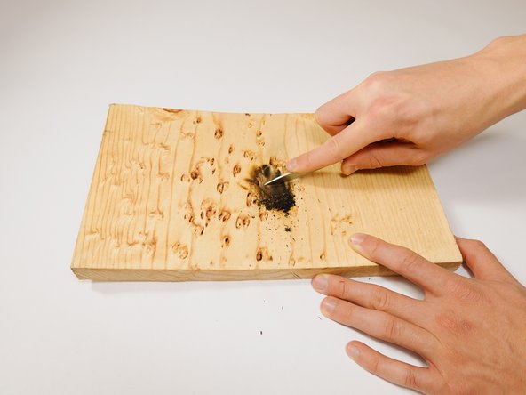

  2. How to Remove a Burn Mark on a Wooden Floor: step 2, image 1 of 1
    • Use a pocket knife to carefully grind off the burn mark.
    • Grind parallel to the wood grain.

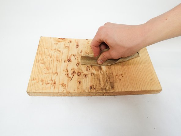

  3. How to Remove a Burn Mark on a Wooden Floor: step 3, image 1 of 1
    • Sand the area using 150 grit sandpaper until smooth, diminishing the crevice.

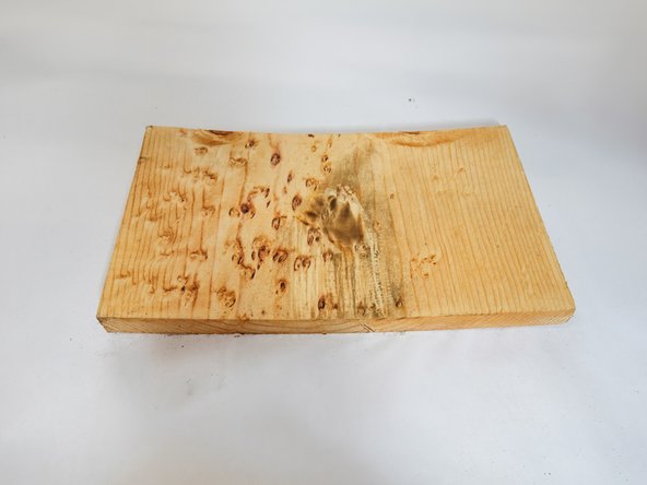

  4. How to Remove a Burn Mark on a Wooden Floor: step 4, image 1 of 1
    • Wipe off the area, ridding any sanded particles.

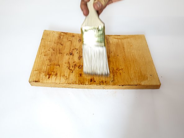

  5. How to Remove a Burn Mark on a Wooden Floor: step 5, image 1 of 1
    • Use a brush to apply a small amount of wood polish on the sanded area.
    • Make sure to use wood polish consistent to rest of the floor.
  6. How to Remove a Burn Mark on a Wooden Floor: step 6, image 1 of 1
    • Let the polish dry, applying another layer if necessary.
