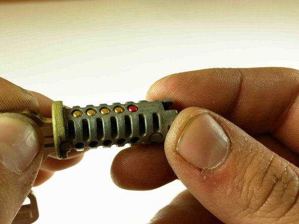

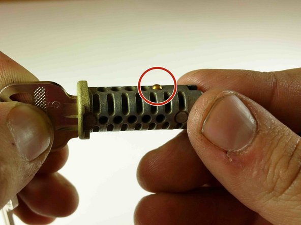

  11. How to Rekey a Kwikset Deadbolt Lock: step 11, image 1 of 3 How to Rekey a Kwikset Deadbolt Lock: step 11, image 2 of 3 How to Rekey a Kwikset Deadbolt Lock: step 11, image 3 of 3
    • Place the bottom pins into the pin holes until the top of the new pin matches the shear line.
    • Pins that are in the correct position will be flush with the shear line. Incorrect pin placement will be above or below the shear line. The red circle displays an incorrect placement as the pin is above the shear line.
