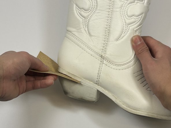

  2. How to Reinforce a Cowboy Boot Heel: step 2, image 1 of 2 How to Reinforce a Cowboy Boot Heel: step 2, image 2 of 2
    • Take a piece of sandpaper and sand down the inside of the broken heel.
    • This will allow the glue to adhere to a smooth surface.

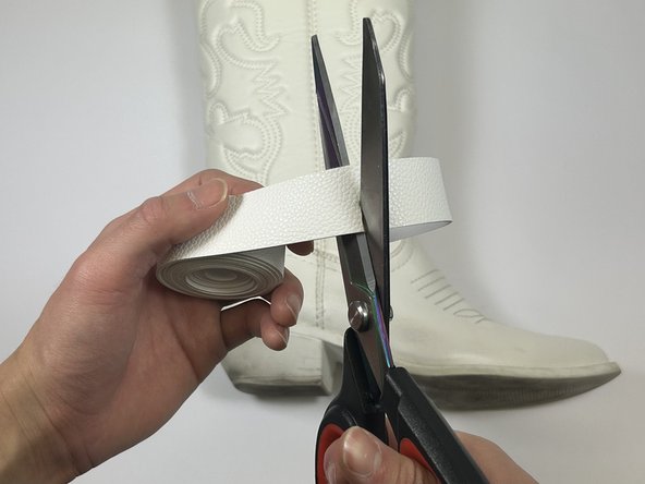

  5. How to Reinforce a Cowboy Boot Heel: step 5, image 1 of 3 How to Reinforce a Cowboy Boot Heel: step 5, image 2 of 3 How to Reinforce a Cowboy Boot Heel: step 5, image 3 of 3
    • Measure the length of each side of the heel with the leather strip.
    • Cut two pieces of leather using scissors corresponding to the measured length of the right and left side of the heel.
    • If the leather strips are too thick, cut the measured leather strips vertically in half for thinner strips.

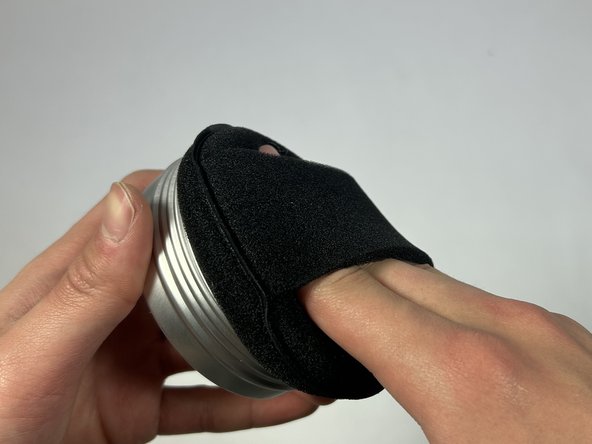

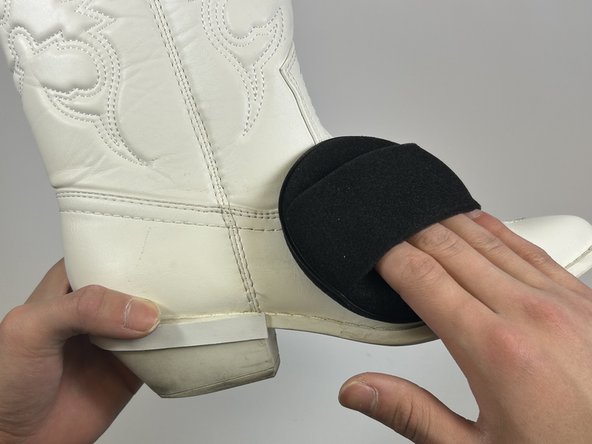

  8. How to Reinforce a Cowboy Boot Heel: step 8, image 1 of 3 How to Reinforce a Cowboy Boot Heel: step 8, image 2 of 3 How to Reinforce a Cowboy Boot Heel: step 8, image 3 of 3
    • Rub the sponge on the mink oil for 30 seconds.
    • Apply the oil to the leather parts of the boot.
    • Mink oil waterproofs, restores, and protects the leather.
