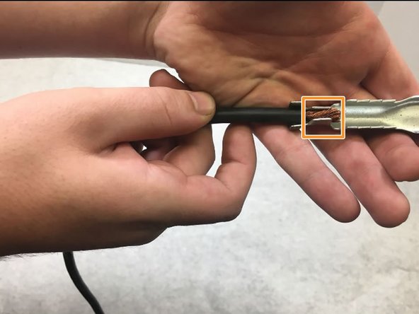

  1. How to Reconnect an Alligator Clamp to a Battery Charging Cable, How to Reconnect an Alligator Clamp to a Battery Charging Cable: step 1, image 1 of 2 How to Reconnect an Alligator Clamp to a Battery Charging Cable, How to Reconnect an Alligator Clamp to a Battery Charging Cable: step 1, image 2 of 2
    • Determine which handle of the alligator clamp originally secured the charging cable. (The tabs will be pressed down and there will most likely be remnants of copper strands)
    • Slide the rubber grip off of the handle which did NOT originally secure the charging cable.
