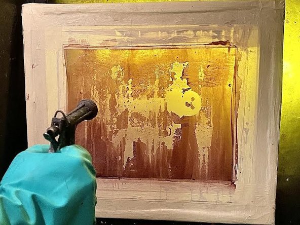

  3. How to Reclaim A Silk Screen: step 3, image 1 of 2 How to Reclaim A Silk Screen: step 3, image 2 of 2
    • Use your pressure washer at near-full power, making sure to get the emulsion off every part of the screen.
    • For safety, wear safety gloves and keep your hands away from the water. A pressure washer is strong enough to pierce skin.

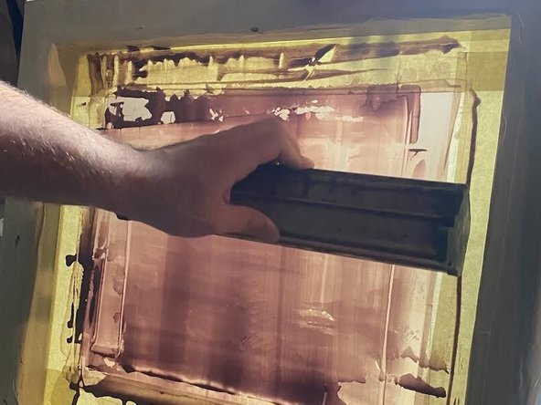

    • Apply 2 layers of emulsion to each side of your screen using the thicker side of the scoop coater, removing excess using the small plastic squeegee.
    • You must work quickly as emulsion is light sensitive.
    • Once done applying, let it air dry for another 1.5 hours or until completely dry.

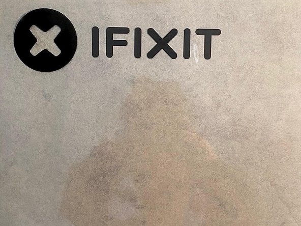

  8. How to Reclaim A Silk Screen: step 8, image 1 of 3 How to Reclaim A Silk Screen: step 8, image 2 of 3 How to Reclaim A Silk Screen: step 8, image 3 of 3
    • Power wash your screen with even power until your design peels off.
    • Spray both sides evenly.
    • Do not focus on a single area, as you can ruin the design and have to repeat the process again.
