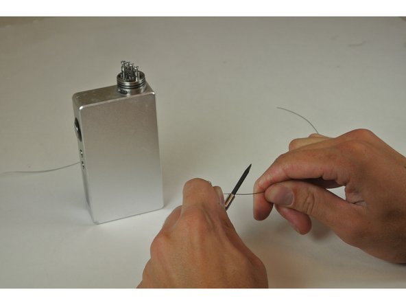

  3. How to Rebuild and Replace the Coils in a Mutation X V4 Atomizer: step 3, image 1 of 1
    • Hold the screwdriver and the wire end in one hand (non dominant) and the loose end of the wire in the other hand (dominant).
  4. How to Rebuild and Replace the Coils in a Mutation X V4 Atomizer: step 4, image 1 of 1
    • Using the loose end of the wire, wrap 4-8 times (depending on desired ohms) around the screwdriver.
    • Note: More loops is more ohms of resistance, experiment until you find the proper amount of loops for you.
  5. How to Rebuild and Replace the Coils in a Mutation X V4 Atomizer: step 5, image 1 of 1
    • Leave wire wrapped around screwdriver and use fingernails to push the coil down towards base of screwdriver.
  6. How to Rebuild and Replace the Coils in a Mutation X V4 Atomizer: step 6, image 1 of 1
    • Carefully slide the coil off of the screwdriver.
    • Note: Try not to warp the coil.

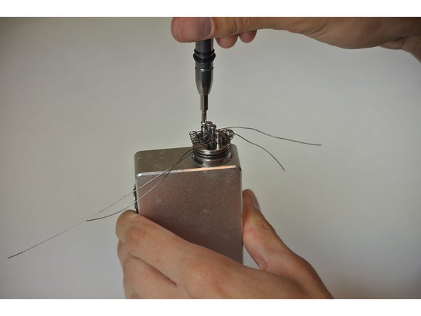

  10. How to Rebuild and Replace the Coils in a Mutation X V4 Atomizer: step 10, image 1 of 2 How to Rebuild and Replace the Coils in a Mutation X V4 Atomizer: step 10, image 2 of 2
    • Put one end of the coil in an outermost hole on side of screw and other end in one of the inner holes.
    • CAUTION: Alternate holes when placing wire inside of screws to avoid shorting the product. EX: holes 1 & 3 and holes 2 & 4 on the above picture
  11. How to Rebuild and Replace the Coils in a Mutation X V4 Atomizer: step 11, image 1 of 2 How to Rebuild and Replace the Coils in a Mutation X V4 Atomizer: step 11, image 2 of 2
    • Repeat step 10 on other side with other coil.
  12. How to Rebuild and Replace the Coils in a Mutation X V4 Atomizer: step 12, image 1 of 1
    • Tighten the screws completely once coils are in desired position.

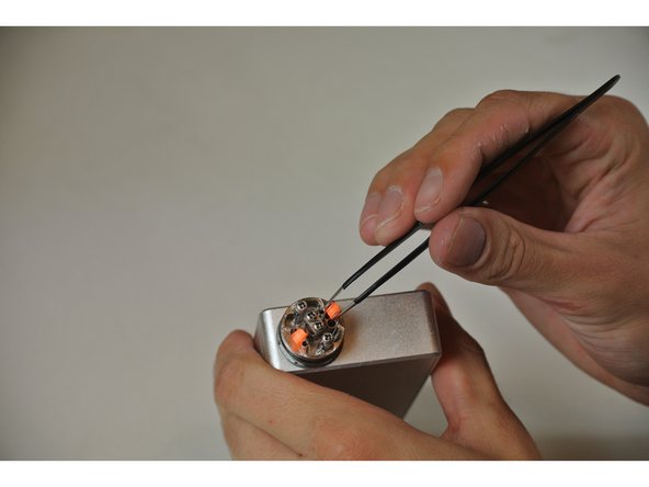

    • Press the biggest button on vape to heat up coils until red hot.
  17. How to Rebuild and Replace the Coils in a Mutation X V4 Atomizer: step 17, image 1 of 2 How to Rebuild and Replace the Coils in a Mutation X V4 Atomizer: step 17, image 2 of 2
    Tool used on this step:
    Buy
    • Use tweezers to compress the coils, being careful not to touch the tweezers to the coils while the button is being pressed.
    • CAUTION: If the tweezers are placed on the coils while the button is being pressed, the user may sustain small burns.
  18. How to Rebuild and Replace the Coils in a Mutation X V4 Atomizer: step 18, image 1 of 1
    • Repeat on other side. Coils are ready when both sides glow red hot at the same time.
