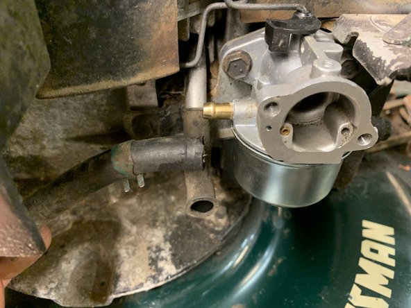

  4. How to Rebuild a Briggs and Stratton Quantum Engine Carburetor: step 4, image 1 of 3 How to Rebuild a Briggs and Stratton Quantum Engine Carburetor: step 4, image 2 of 3 How to Rebuild a Briggs and Stratton Quantum Engine Carburetor: step 4, image 3 of 3
    • Remove the fuel line spring clamp with pliers.
    • Remove the fuel line from the carburetor by pulling directly outward.
    • Crimp the line with locking pliers. Do this before removing the fuel line to mitigate fuel spillage.
    • Drain the fuel line into a container and dispose of it properly.

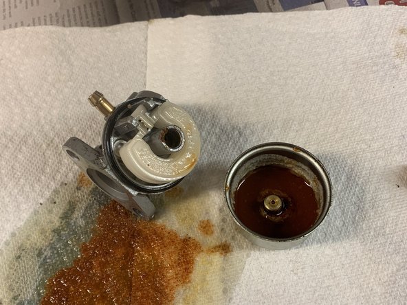

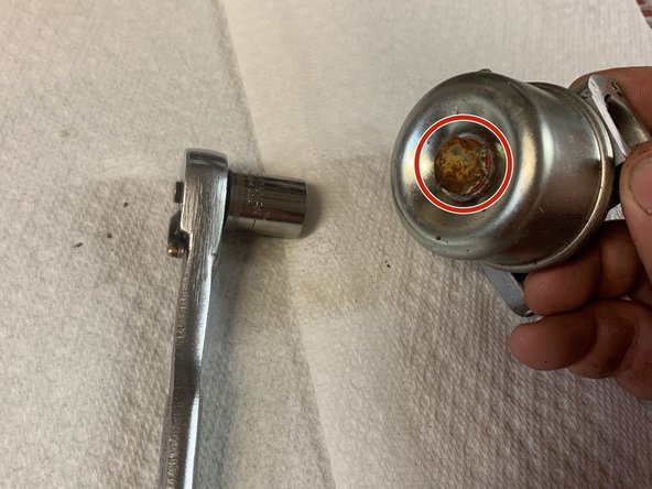

  6. How to Rebuild a Briggs and Stratton Quantum Engine Carburetor: step 6, image 1 of 3 How to Rebuild a Briggs and Stratton Quantum Engine Carburetor: step 6, image 2 of 3 How to Rebuild a Briggs and Stratton Quantum Engine Carburetor: step 6, image 3 of 3
    • Remove the carburetor bowl screw with a 1/2" socket and ratchet.
    • Empty fuel from the carburetor bowl into a container for disposal.

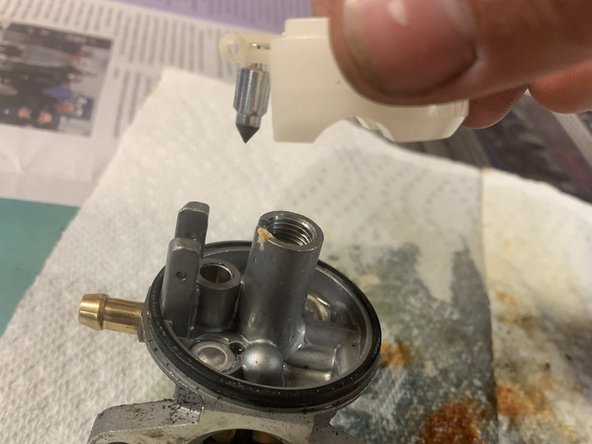

  7. How to Rebuild a Briggs and Stratton Quantum Engine Carburetor: step 7, image 1 of 3 How to Rebuild a Briggs and Stratton Quantum Engine Carburetor: step 7, image 2 of 3 How to Rebuild a Briggs and Stratton Quantum Engine Carburetor: step 7, image 3 of 3
    • Spray the interior of the carburetor with carb cleaner.
    • Remove the float pin.
    • This will allow the float and needle to be removed as one piece.
    • This is not a full carburetor cleaning. This is just a rinse-off.

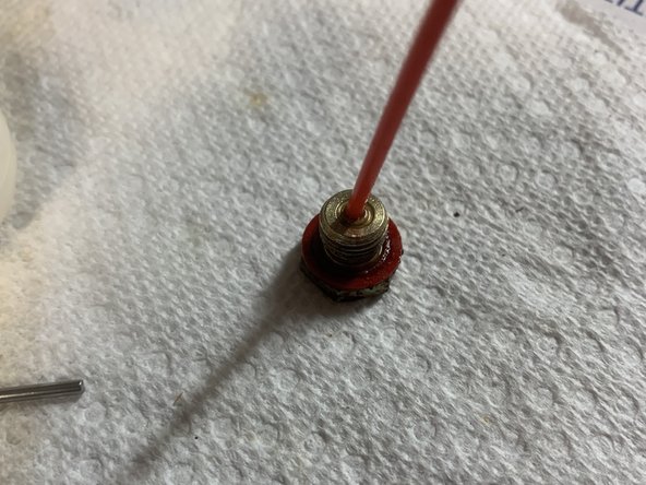

  8. How to Rebuild a Briggs and Stratton Quantum Engine Carburetor: step 8, image 1 of 3 How to Rebuild a Briggs and Stratton Quantum Engine Carburetor: step 8, image 2 of 3 How to Rebuild a Briggs and Stratton Quantum Engine Carburetor: step 8, image 3 of 3
    • Spray out the three major spots in the following order: the main adjustment hole, the inlet needle hole, and the main jet.
    • If the carb cleaner does not pass through any component, use a small piece of wire to poke through the passage.
    • If using a needle to clear passages, spray the passages with carb cleaner after clearing.
