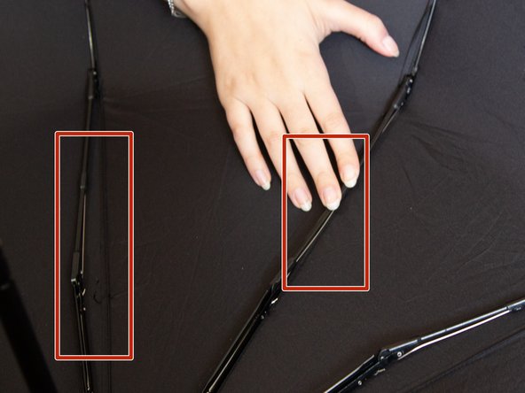

    • Open the umbrella and identify any metal ribs that have detached from the fabric panel.

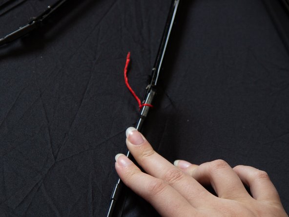

    • Tie a knot two inches from the end of the thread.
    • Place the opposite end of the thread into a sewing needle.
    • Rubbing or wetting the end of the thread may make it easier to insert the thread into the sewing needle.

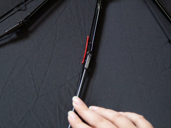

    • Insert the sewing needle through the umbrella fabric panel and pull the thread through.
    • Poke the sewing needle through the underside of the fabric panel on the opposite side of the metal rib and pull the thread through.
  5. How to Reattach a Metal Rib to Fabric Panel on an Umbrella: step 5, image 1 of 3 How to Reattach a Metal Rib to Fabric Panel on an Umbrella: step 5, image 2 of 3 How to Reattach a Metal Rib to Fabric Panel on an Umbrella: step 5, image 3 of 3
    • Pull the sewing needle and thread across to wrap around the metal rib.
    • Insert the sewing needle through the fabric panel and pull the thread through.
    • Repeat Steps 4 and 5 until the metal rib is tightly secured to the fabric panel. Three additional loops is recommended.

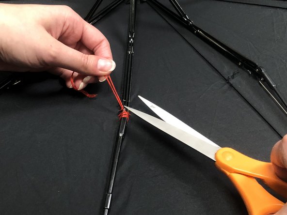

    • Remove the thread from the sewing needle.
    • Tie the loose end of the string to the end of the string with the knot from Step 2.
  7. How to Reattach a Metal Rib to Fabric Panel on an Umbrella: step 7, image 1 of 3 How to Reattach a Metal Rib to Fabric Panel on an Umbrella: step 7, image 2 of 3 How to Reattach a Metal Rib to Fabric Panel on an Umbrella: step 7, image 3 of 3
    • Don't run with scissors!
    • Use scissors to cut off any excess thread.
    • If necessary, remove any scotch tape pieces.
