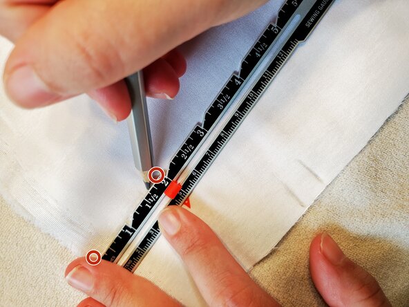

      • Measure the area to be patched using a ruler with a sliding bead or sewing measurement tape.
      • If using a tape, use pins to keep the tape straight when measuring the area to be patched.
      • Round up the measurements to ensure the patch is slightly larger than the area that needs to be patched.
      • For example, most of my measurements were 1.75 inches, so I wrote down 2 inches for the length, width, and height.

      • Trace the recorded measurements for your patch onto the patch fabric using a fabric pencil/marker.
      • A pencil is better for white fabric, and a marker is better for dark or thick fabric.
      • I used satin fabric for my patch cloth because the outer part of the corset is made of satin. Color matching is only important if the garment being patched is being worn outside clothing. My corset is an undergarment, so while I used white satin I didn't use an exact color-match.
