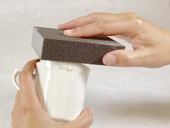

    10. How to Mend Broken China: step 10, image 1 of 2 How to Mend Broken China: step 10, image 2 of 2
      • Use coarse sandpaper to further reduce the excess epoxy.
      Ask FixBot
    11. How to Mend Broken China: step 11, image 1 of 1
      • Use fine sandpaper to smooth out remaining inconsistencies.
      Ask FixBot
    12. How to Mend Broken China: step 12, image 1 of 2 How to Mend Broken China: step 12, image 2 of 2
      • Darker cracks form where the clear epoxy functions as filler, but the cup will work perfectly fine! Add colored pigment to the epoxy for a more subtle repair.
