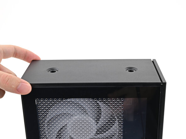

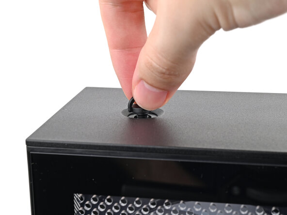

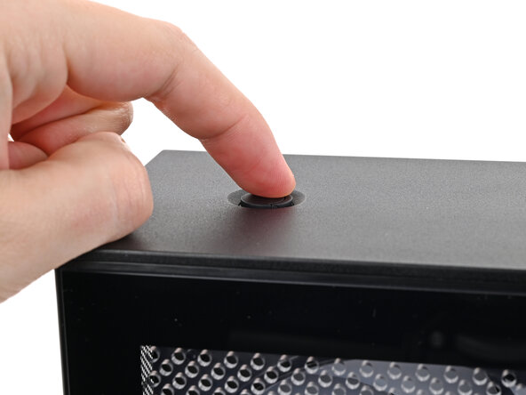

  3. How to Install an 80mm Fan in your Framework Desktop, Remove the Top Panel screws: step 3, image 1 of 3 How to Install an 80mm Fan in your Framework Desktop, Remove the Top Panel screws: step 3, image 2 of 3 How to Install an 80mm Fan in your Framework Desktop, Remove the Top Panel screws: step 3, image 3 of 3
    • Use your finger to lift up the two D-rings on the Top Panel screws.

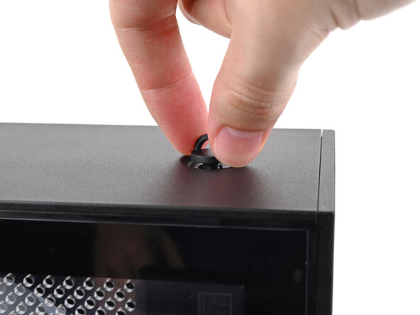

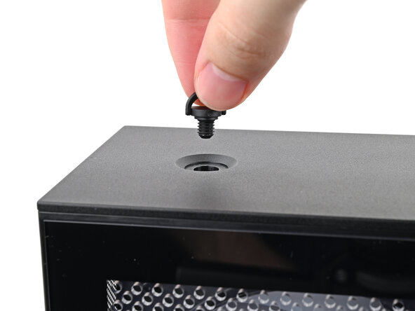

  4. How to Install an 80mm Fan in your Framework Desktop: step 4, image 1 of 3 How to Install an 80mm Fan in your Framework Desktop: step 4, image 2 of 3 How to Install an 80mm Fan in your Framework Desktop: step 4, image 3 of 3
    • Use your fingers to twist the screw counter-clockwise and loosen it.
    • Remove the Top Panel screw.

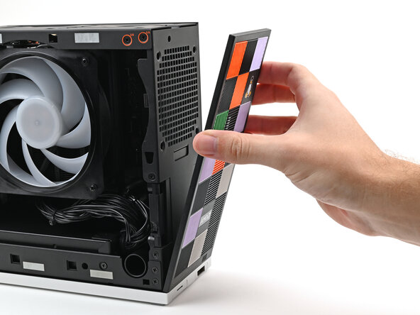

  6. How to Install an 80mm Fan in your Framework Desktop, Remove the Top Panel: step 6, image 1 of 3 How to Install an 80mm Fan in your Framework Desktop, Remove the Top Panel: step 6, image 2 of 3 How to Install an 80mm Fan in your Framework Desktop, Remove the Top Panel: step 6, image 3 of 3
    • Slide the Top Panel towards the rear of the computer to release the clips securing it to the chassis.
    • If you're having a hard time gripping the Top Panel, use the screw holes to get a better handhold.
    • Lift the Top Panel off the chassis and remove it.

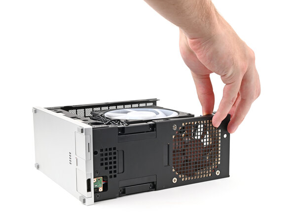

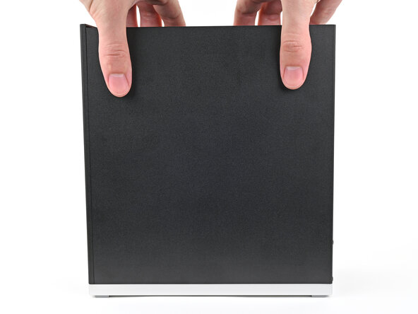

  8. How to Install an 80mm Fan in your Framework Desktop, Remove the Right Panel: step 8, image 1 of 3 How to Install an 80mm Fan in your Framework Desktop, Remove the Right Panel: step 8, image 2 of 3 How to Install an 80mm Fan in your Framework Desktop, Remove the Right Panel: step 8, image 3 of 3
    • Use your fingers to grip the top of the Right Panel and slide it upward to release its clips.
    • Remove the Right Panel.

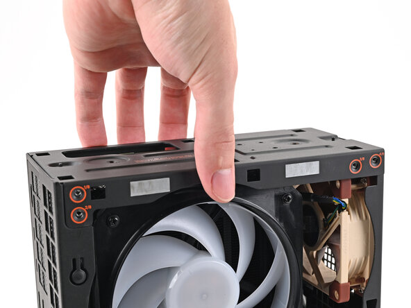

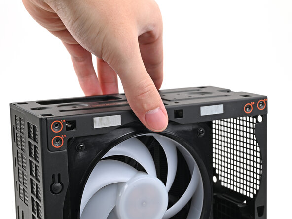

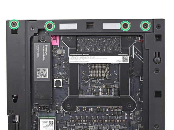

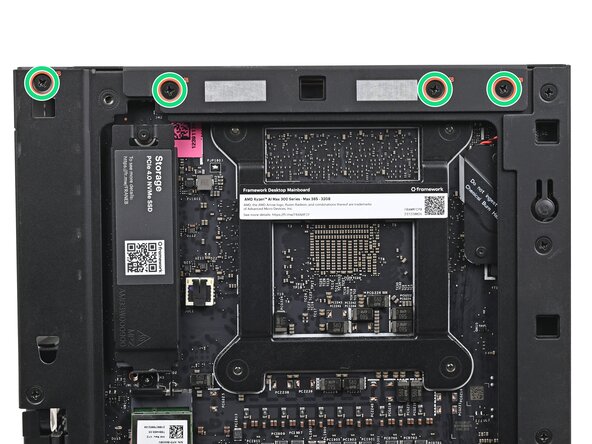

  9. How to Install an 80mm Fan in your Framework Desktop, Remove the top plate screws: step 9, image 1 of 3 How to Install an 80mm Fan in your Framework Desktop, Remove the top plate screws: step 9, image 2 of 3 How to Install an 80mm Fan in your Framework Desktop, Remove the top plate screws: step 9, image 3 of 3
    • While holding the Desktop steady, use your Framework Desktop Screwdriver to remove the eight 4.0 mm‑long Phillips screws securing the top plate.

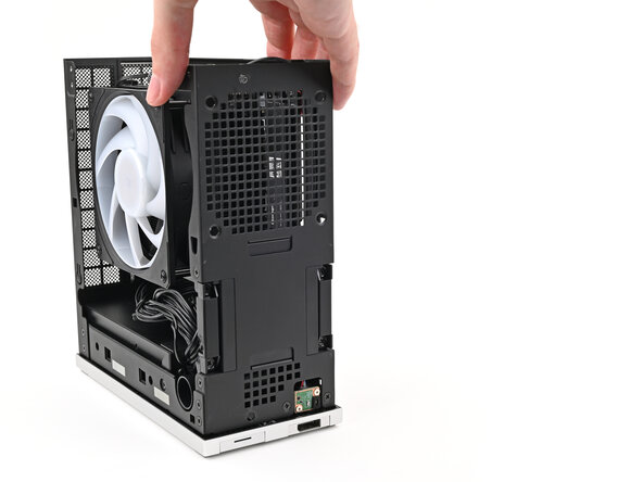

  10. How to Install an 80mm Fan in your Framework Desktop, Remove the top plate: step 10, image 1 of 2 How to Install an 80mm Fan in your Framework Desktop, Remove the top plate: step 10, image 2 of 2
    • Lift the top plate off the Desktop and remove it.

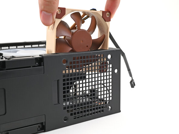

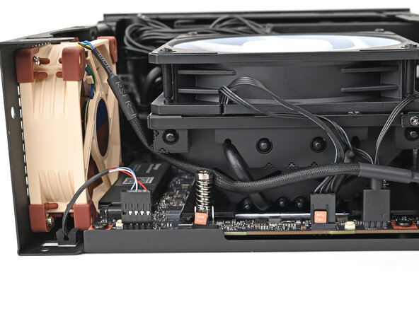

  12. How to Install an 80mm Fan in your Framework Desktop, Insert the fan: step 12, image 1 of 2 How to Install an 80mm Fan in your Framework Desktop, Insert the fan: step 12, image 2 of 2
    • Orient the fan so its label is facing away from the chassis fan grille and the cable is pointing up.
    • If your fan has an arrow indicating airflow direction, make sure it's pointed towards the heatsink.
    • If you're using a different fan, orient it such that the fan is blowing into the Desktop, not away.
    • Insert the fan into the chassis and along the front plate, making sure that the screw holes in the chassis and the fan are aligned.
  13. How to Install an 80mm Fan in your Framework Desktop, Install the fan screws: step 13, image 1 of 2 How to Install an 80mm Fan in your Framework Desktop, Install the fan screws: step 13, image 2 of 2
    • Use your Framework Desktop Screwdriver to install the four screws securing the secondary fan.
    • Most fans of this type use self-tapping screws that will carve threads into your fan's screw holes. This is normal and necessary for the fan to be secured.
  14. How to Install an 80mm Fan in your Framework Desktop, Connect the fan: step 14, image 1 of 2 How to Install an 80mm Fan in your Framework Desktop, Connect the fan: step 14, image 2 of 2
    • Orient the fan cable so its two vertical lines are facing you.
    • Slide the fan cable over the four-pronged connector labeled "Sys Fan 2," making sure the orange label slots between the vertical lines.
    • You can also connect the cable into the "Sys Fan 1" slot depending on the cable's length and orientation.

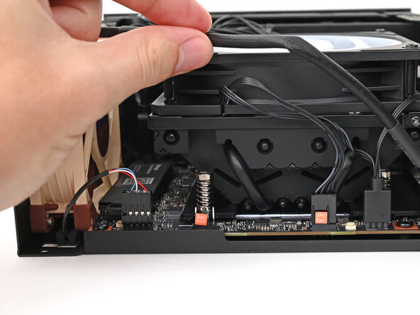

  15. How to Install an 80mm Fan in your Framework Desktop, Reposition the cable: step 15, image 1 of 3 How to Install an 80mm Fan in your Framework Desktop, Reposition the cable: step 15, image 2 of 3 How to Install an 80mm Fan in your Framework Desktop, Reposition the cable: step 15, image 3 of 3
    • Move the fan cable underneath the heat sink and tuck it behind the silver screw post.

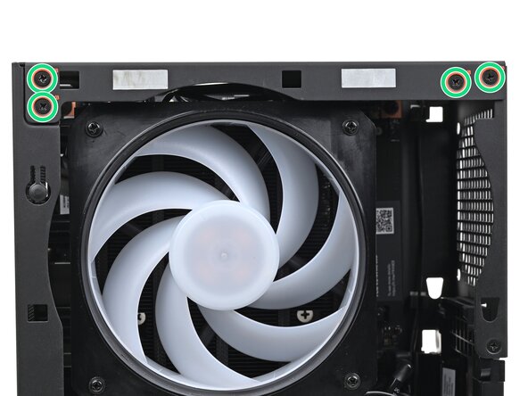

  17. How to Install an 80mm Fan in your Framework Desktop, Place the top plate: step 17, image 1 of 2 How to Install an 80mm Fan in your Framework Desktop, Place the top plate: step 17, image 2 of 2
    • Place the top plate on top of the Desktop, making sure it slots into the chassis so the orange circles are visible.
  18. How to Install an 80mm Fan in your Framework Desktop: step 18, image 1 of 2 How to Install an 80mm Fan in your Framework Desktop: step 18, image 2 of 2
    • Make sure the matching screw hole on the top plate labeled "5/8" is slotted on the inside of the Chassis so that the orange circle is visible.
  19. How to Install an 80mm Fan in your Framework Desktop, Install the top plate screws: step 19, image 1 of 3 How to Install an 80mm Fan in your Framework Desktop, Install the top plate screws: step 19, image 2 of 3 How to Install an 80mm Fan in your Framework Desktop, Install the top plate screws: step 19, image 3 of 3
    • While holding the Desktop steady, use your Framework Desktop Screwdriver to install the eight 4.0 mm‑long Phillips screws securing the top plate.

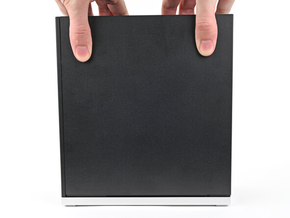

  21. How to Install an 80mm Fan in your Framework Desktop, Install the Front Panel: step 21, image 1 of 3 How to Install an 80mm Fan in your Framework Desktop, Install the Front Panel: step 21, image 2 of 3 How to Install an 80mm Fan in your Framework Desktop, Install the Front Panel: step 21, image 3 of 3
    • Lay the bottom of the Front Panel on the small, protruding lip in the silver base to align its tabs.
    • Press the Front Panel flat to the chassis and let it align to the magnets.

  23. How to Install an 80mm Fan in your Framework Desktop, Install the Top Panel: step 23, image 1 of 3 How to Install an 80mm Fan in your Framework Desktop, Install the Top Panel: step 23, image 2 of 3 How to Install an 80mm Fan in your Framework Desktop, Install the Top Panel: step 23, image 3 of 3
    • Orient the Top Panel so its arrow is pointing towards the rear of the computer.
    • While holding the Top Panel at a slight downward angle, slide it across the top of the chassis (from rear to front) until you feel its clips catch.
    • There should be a small gap between the Top Panel and the front of the Desktop.
    • Lay the Top Panel flat on the chassis to align the remaining clips.
  24. How to Install an 80mm Fan in your Framework Desktop: step 24, image 1 of 2 How to Install an 80mm Fan in your Framework Desktop: step 24, image 2 of 2
    • While securing the computer with one hand, use the other hand to slide the Top Panel towards the front of the computer to close the gap and engage the clips.
