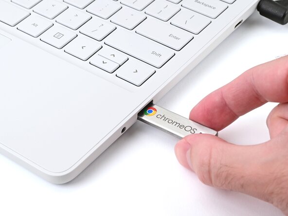

Connect the USB flash drive to the fastest available port on the computer.
Use a USB 3 drive connected to a USB 3 port for faster installation. USB 3 ports are usually colored blue and/or labeled SuperSpeed (SS).

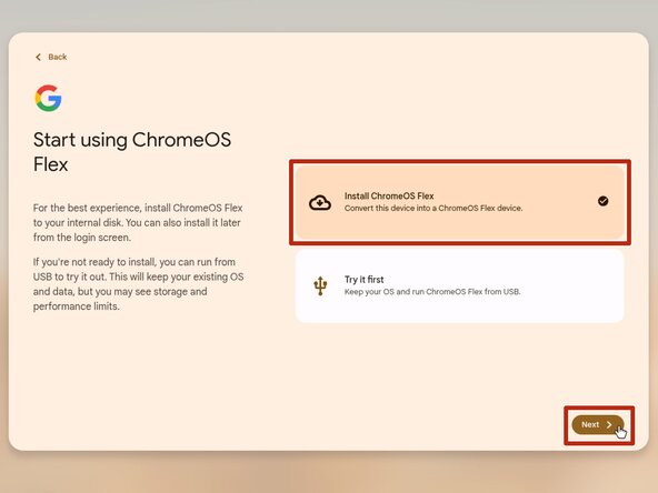

Ensure the Install ChromeOS Flex option is selected, then click Next.
Review the warning explaining that the installer will permanently erase the data on the computer.
Click Install ChromeOS Flex when you're ready to install. Then, click Install on the pop‑up window.
