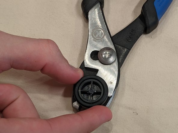

  6. How to Fix the Scroll Wheel of a Wired HP Mouse: step 6, image 1 of 1
    • Place the scroll wheel inside the jaws of the basic pliers such that the broken side is facing up.
  7. How to Fix the Scroll Wheel of a Wired HP Mouse: step 7, image 1 of 1
    • Holding the axle with a pair of small pliers, place a small amount of glue on the broken end of the axle.
    • Be careful to not get glue on yourself or any of the circuit components.
  8. How to Fix the Scroll Wheel of a Wired HP Mouse: step 8, image 1 of 1
    • Place the axle on the scroll wheel in the position of best fit, and allow to sit for several hours to dry.

Props for the effort, but this will not hold for long, glued plastic will snap again soon.
