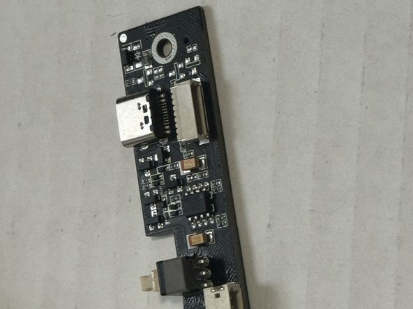

  5. How to Fix the James Donkey RS2 2.0 Switch or Motherboard: step 5, image 1 of 2 How to Fix the James Donkey RS2 2.0 Switch or Motherboard: step 5, image 2 of 2
    • Then plug it back into the PCB. What we get will be a small board connected to the big board.
  6. How to Fix the James Donkey RS2 2.0 Switch or Motherboard: step 6, image 1 of 1
    • Connect the board to the computer, and turn the circuit on to test to see where the problem is.
  7. How to Fix the James Donkey RS2 2.0 Switch or Motherboard: step 7, image 1 of 1
    • To figure out if is it connected or not, first open the key tester on a computer that has been connected to the keyboard.
  8. How to Fix the James Donkey RS2 2.0 Switch or Motherboard: step 8, image 1 of 1
    • Use the metal tweezer to connect the silver part under the PCB.
  9. How to Fix the James Donkey RS2 2.0 Switch or Motherboard: step 9, image 1 of 1
    • If everything works fine, it should light in green, which means the key has been sensed.
  10. How to Fix the James Donkey RS2 2.0 Switch or Motherboard: step 10, image 1 of 1
    • If there is just one single key that is unable to react, then switch it.
  11. How to Fix the James Donkey RS2 2.0 Switch or Motherboard: step 11, image 1 of 1
    • If there is a line that has no reaction, which means PCB is malfunctioning, send it back for repair.

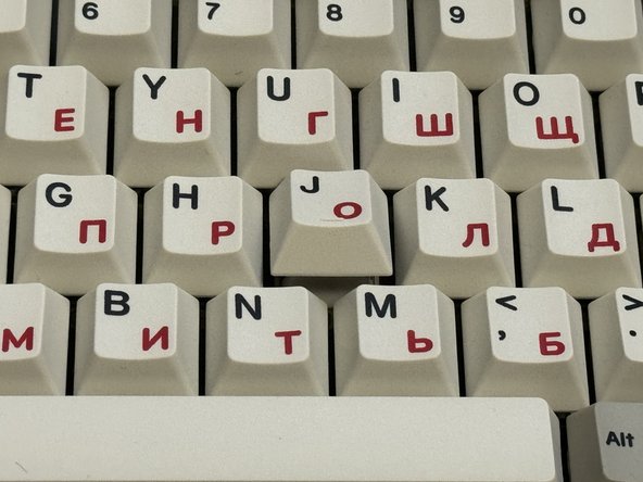

  12. How to Fix the James Donkey RS2 2.0 Switch or Motherboard: step 12, image 1 of 2 How to Fix the James Donkey RS2 2.0 Switch or Motherboard: step 12, image 2 of 2
    • Here is how to switch the switches. First, unplug the keycap.
  13. How to Fix the James Donkey RS2 2.0 Switch or Motherboard: step 13, image 1 of 2 How to Fix the James Donkey RS2 2.0 Switch or Motherboard: step 13, image 2 of 2
    • Then unplug the switch.
