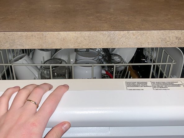

  4. How to Fix a Whirlpool WDF330PAHW Door Latch: step 4, image 1 of 2 How to Fix a Whirlpool WDF330PAHW Door Latch: step 4, image 2 of 2
    • Carefully raise the dishwasher door to align the door latch with the strike plate.
    • Watch fingers while raising dishwasher door.

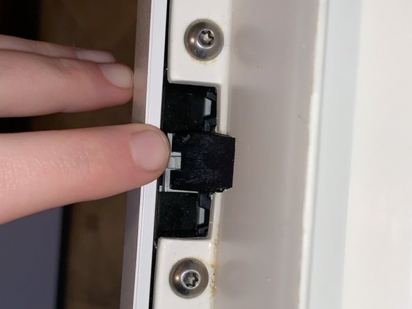

  5. How to Fix a Whirlpool WDF330PAHW Door Latch: step 5, image 1 of 1
    • Hold the door latch with your finger tips to align the door latch.
    • Then lower the door and tighten the door latch securing bolts.
