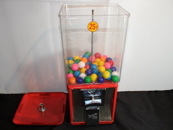

      • Remove the lid of the machine.
      • Remove candy from container and place aside in a bowl.

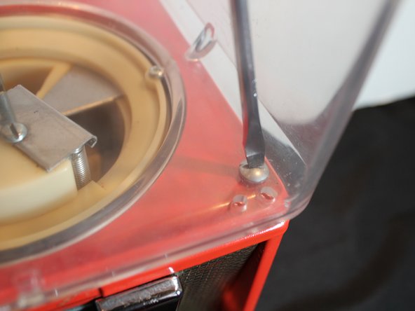

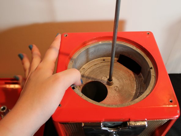

    2. How to Fix a Stuck Quarter in a  Candy Machine: step 2, image 1 of 3 How to Fix a Stuck Quarter in a  Candy Machine: step 2, image 2 of 3 How to Fix a Stuck Quarter in a  Candy Machine: step 2, image 3 of 3
      • Using a flathead screwdriver unscrew the four 10mm corner screws.
      • Remove the plastic container and set it aside.

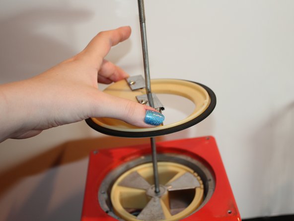

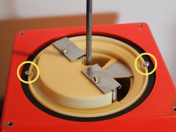

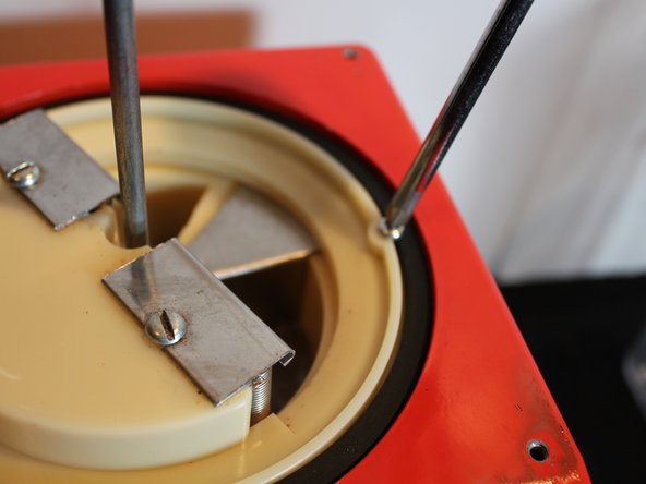

    3. How to Fix a Stuck Quarter in a  Candy Machine: step 3, image 1 of 2 How to Fix a Stuck Quarter in a  Candy Machine: step 3, image 2 of 2
      • Using a Phillips #1 screwdriver remove the two 15mm screws that are marked in the photo.

    4. How to Fix a Stuck Quarter in a  Candy Machine: step 4, image 1 of 2 How to Fix a Stuck Quarter in a  Candy Machine: step 4, image 2 of 2
      • Remove the inner mechanisms by sliding them up and off the metal rod.

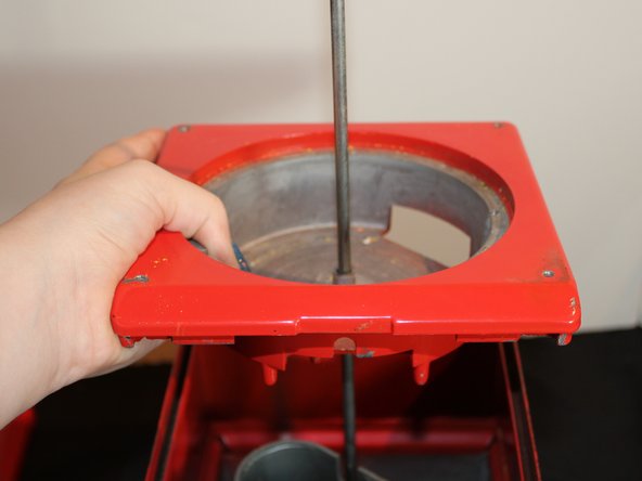

    5. How to Fix a Stuck Quarter in a  Candy Machine: step 5, image 1 of 2 How to Fix a Stuck Quarter in a  Candy Machine: step 5, image 2 of 2
      • Remove the metal top with both hands on the sides.
      • Lift up, sliding it up and off the metal rod.

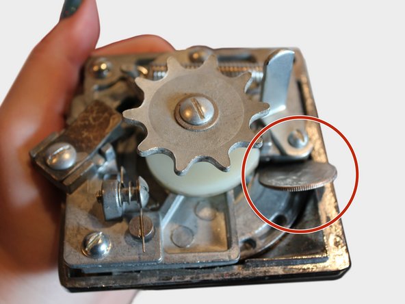

      • Now you can see into the inner mechanisms.
      • Locate the stuck quarter and try to remove it.
      • For better access, lift up the left hinge to release the entire mechanism.

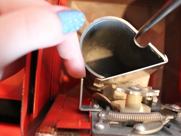

    8. How to Fix a Stuck Quarter in a  Candy Machine: step 8, image 1 of 2 How to Fix a Stuck Quarter in a  Candy Machine: step 8, image 2 of 2
      • Find the stuck quarter in the mechanism.
      • Remove the quarter with your hands by simply pulling (use a plier if needed).
