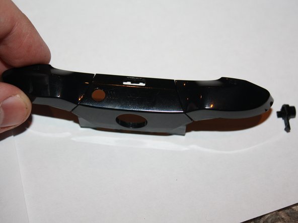

  4. How to Fix a Stuck Button(s) On an Xbox One Controller 1697: step 4, image 1 of 2 How to Fix a Stuck Button(s) On an Xbox One Controller 1697: step 4, image 2 of 2
    • Using your hands or a prying tool, gently remove the top bumper strip from the top of the controller.
    • After removing the bumper piece, a small piece know as the sync button may come off. Make sure to set this aside as it will be important for the reassembly of the controller.
